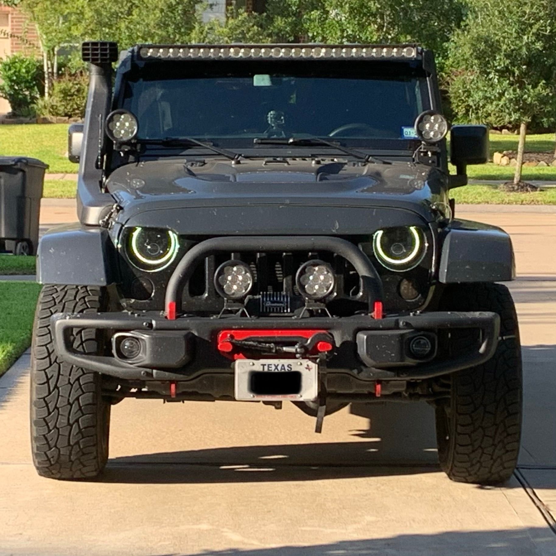

I went to my local Tractor Supply store and got some 7/8ths inch ID washers. Three on each side closed the gap with our just installed Maximus-3 Universal Tow loops and Roadmaster shackle adapters from vendor e-trailer.
We converted a stainless Roadmaster Falcon receiver towbar that uses the usual drop-on fender mount on our recently sold 2002 TJ. Went with the Maximus-3 product for the JKUR that replaced the built TJ Sahara last year because we did NOT want to reduce the front approach angle by using the usual under-bumper under frame tow adapters most folks use - otherwise what's the point in having a trail Jeep?
The Maximus-3 Universal Tow Loops are the two red 5/8" thick HD steel below-bumper tow points

We just finished installing the subj tow points on our 2017 JKUR Recon. We didn't want to go with the usual low-hanging tow bar adapters that severely restricted front approach angles. The Maximus-3 product was one of the better alternatives, while not cheap, it is also a dual use shackle/strap tug/pull point.
Pre-bumper re-install photos of the frame attachment area (front bumper chassis extensions) with strap and U-bolts.
The strap bolts are torqued to 65 ft lbs, they firmly contact the inverted bottom of the tow loop plate in a perpendicular fashion, and also mold to the contour of the top of chassis rail. The front canted galvanized u-bolts u-bolts are of a more conventional design. The mounting area with in-bumper winch and stinger bar reinforcing brackets is very congested. All the parts fit closely together.
The most time-consuming part of the install is cutting (cut-off wheel), smoothing (grinder), and painting (for rust prevention) clearance notches for the tow hooks (red in these photos) in both the steel Mopar 10A/Hard Rock/Recon bumper bottom, and the steel front skid plate.
The clearance notch dimensions specified in the Maximus-3 instructions are accurate for the metal special edition bumper. Dimensions for plastic OEM Jeep bumpers are also included but were not applicable/not used in our application.
