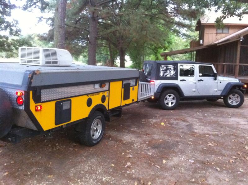

Stock suspension about 350lbs on the tongue. The rear springs sagged about 1.5"~2". steering was fine and not light or flighty. Pulls well.
This trailer weighs about 3800# fully loaded.

Great color, I have the E-2 in grey, I put some Air Lift bags in the rear to keep the Jeep level, they work great. Also, all the towing sites opine that tongue weight should be no less than 10% of total trailer weight, more is O.K. so long as you have something to shift the weight back to the front axle. I load about 500 lbs on the front platform which really increases the tongue wt. Also, I have a better hitch with a 9k lbs capacity. Also, IMHO anytime your trailer wt goes more than 2000 lbs you need some form of trailer brakes.
