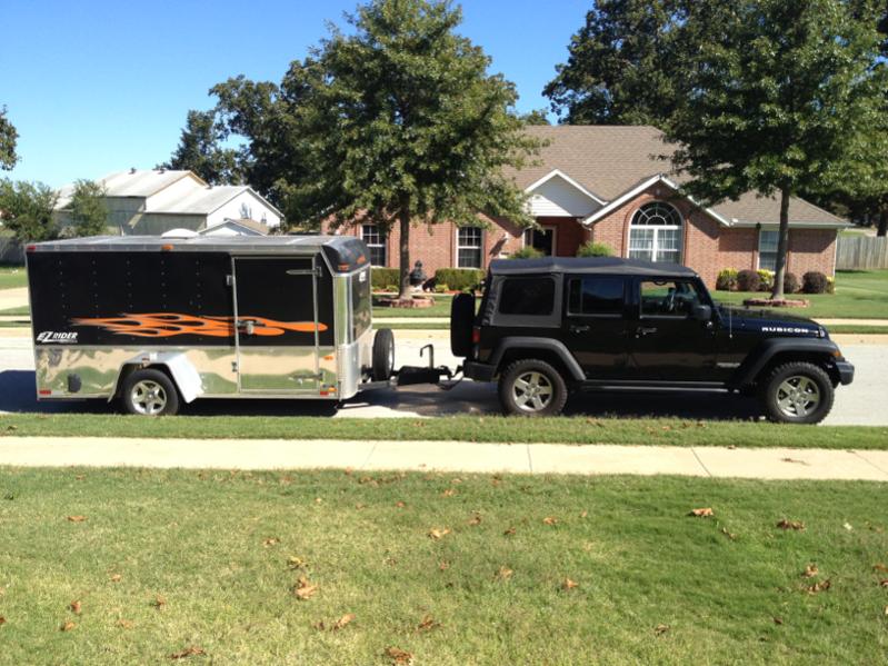

Tried mine out yesterday. I didn't tow it far but did take it out on the interstate. It pulled 70mph in 4th gear ok. It's a 5x12 and weighs around 1800lbs empty.
