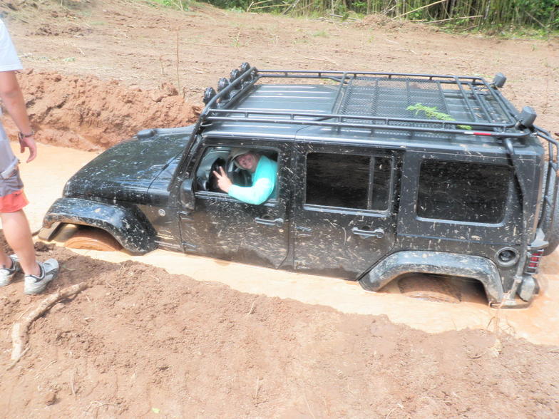

I thought I had wrecked something really bad with the sound I was getting. But a plastic pulley was the culprit. This is the stuff that caused my issue (and my Jeep still smells!!
