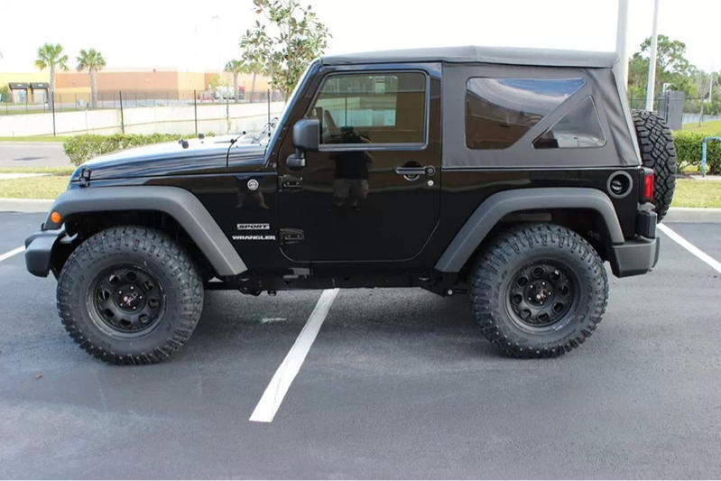

This is my 2014 with 16x8's and 285/75R16. 4.5" back spacing and NO rubbing, trimming or lift. 3.21 gears and still quite fast of the line.

Nice, what brand of wheels are those?

There's no reason to be afraid of getting 33's with 3.21's and a pentastar. I ran 35's with no problem
American Outlaw Patrol
Matte black
Duratrac rubber also
