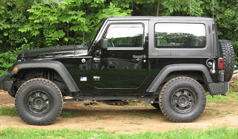

If you're looking for a nice setup for a Sport model, black alloy rims, and bigger tires, I can recommend:
- Prom Comp 7089
Pro Comp 7089 Series - Pro Comp 7089 Cast-Blast Wheels - Xtreme Alloy Cast Wheels Pro Comp Wheels
- Cepek 265/75R16 FC-II
https://www.dickcepek.com/tires.php?item=FunCountry
Yes "Fun Country" sounds a little um, odd... but once you get beyond that... it's a great middle-of-the-road between an all terrain and a mud terrain. Great street tire which also has nice ability to handle mild trails. Unfortunately this is an "E" load range tire which means it's pretty stiff, so I recommend airing it down a little bit to avoid a really harsh ride.
Great combo. I ran with this combo and enjoyed it.
I also tried the 285/75R16 and on a Sport JK, I found that size (33") to be a little too big for the Sport's axle gear ratio. I don't recommend it. If you've got 3.73 gears in your Sport, I'd stick with the 265 not the 285. Proportions also look good IMHO. No spacers needed, no nothing. Absolutely minimal stick-out from fenders too, which is nice. Right on the edge, but I'd be real surprised if anyone gave you grief about it.
Pic of my 2010 Sport (pretty much same as 2014 Sport, except you'll have the Pentastar which improves HP and torque over my '10 3.8L) with this setup. Can't recall whether or not I had the TeraFlex spacer leveling kit install in this pic - I think I did though. With or without it though, no rubbing.

Thanks, I've liked the Dick Cepek tires for quite a few years. I never thought about the gears though so thanks for bringing that up. Maybe instead of 33's, I'll go to 31's. Your Jeep looks great!
