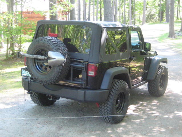

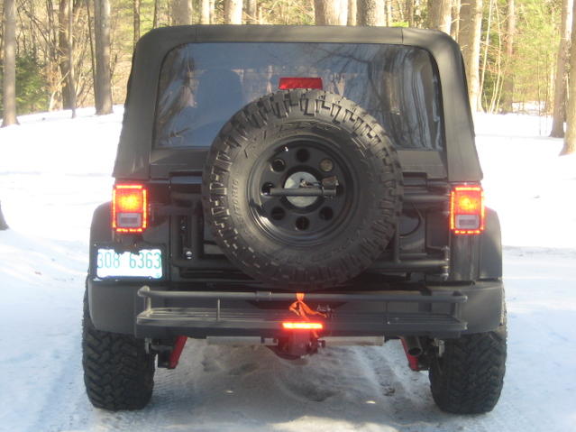

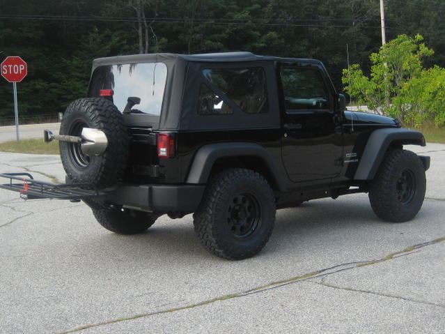

Default i had 33 s on my 2011 sport 3.21 gearing
actual height is 31. 8 on trail grapplers nitto they wete fine I swapped them over to my 12 rubicon
even better on this one pick of the sport and rubicon no lift no need for one realy

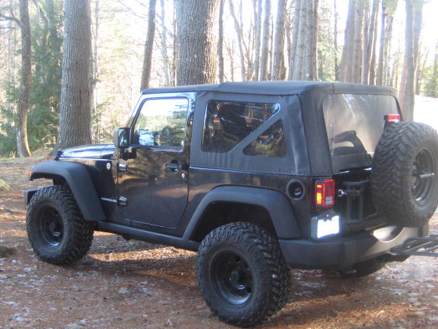

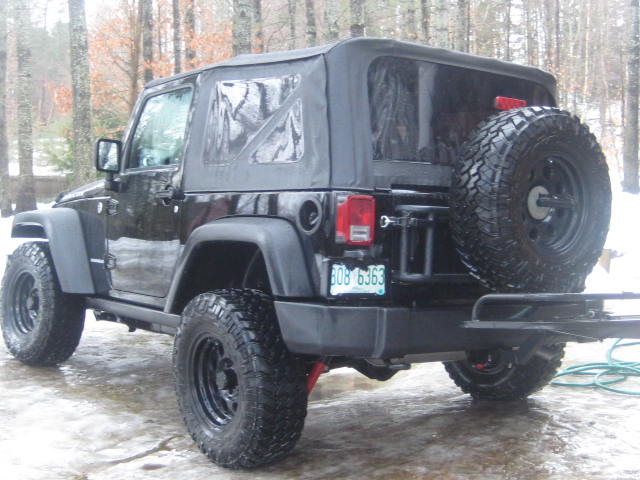

bs is 4.5
on 8.5 " wheels the tires are 11,5 wide on 285 70- 16 to me they fit well not small and plenty of wheel well area and good stance too im very happy and wont be going with a lift or 35s

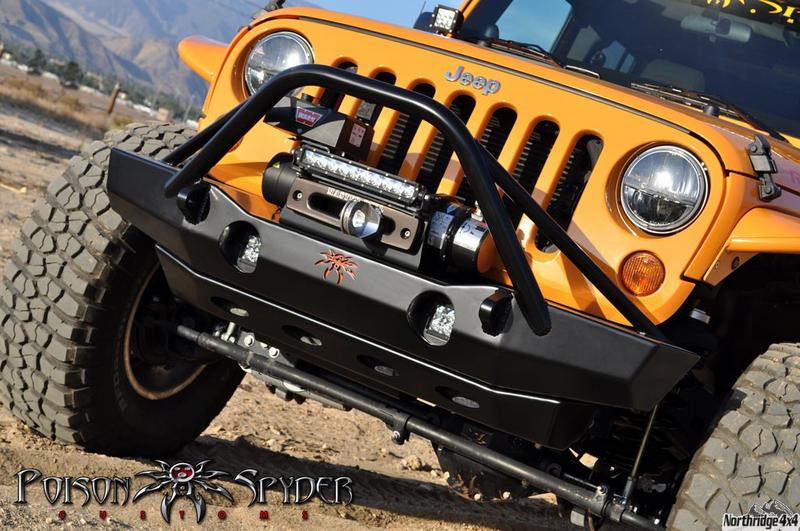

personaly I don't like the look of a lifted jeep I like it low yet built to handle off road stuff . I don't drop off boulders so theres not much of the need to raise the diff up a couple inches . be putting my ps mid bumper / skid on front soon ,its all ready to go on . prob no winch at this point its a solid bumper .
dura trac look good too from what ive seen in pics little less aggressive not E rated as toyo or nitto so sidewalls are thin but that = less weght too and with 321 gearing you might feel that and pull them better with less weight , I think but not sure that 12.5 wide tires on a 8 " wheel with 3.75 bs is about the same as 8.5 wheel with 4.5 bs as far as tires outside flair ? for 410 gearing in my rubicon the weight isn't a issue each tire with wheel is 85 lbs
