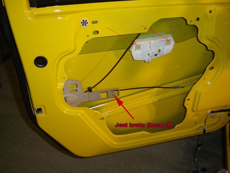

The door comes apart a little easier than your method. Note the two dimpled areas at the bottom of the inner panel. Cut those out and adjust window to align the bottom of the window bracket to the holes. press the retainers on the bottom of the glass with a straight screw driver and pull the window up out of the regulator bracket. Now the inner panel can be removed from the latch bracket and completely removed to access the latch. When you are done slide the glass down into regulator and it will lock into place. Tape over the holes.

I don't know how to upload pictures so please click on the attachments. I placed arrows on your pics. The first pic shows where to cut at the dimples the plastic is very thin in this area as it is designed to be cut. after you cut them out adjust the bottom of glass to be accessed threw the holes. click second pic. I placed arrows where the retainers are. Press the retainer with a srew driver and pull the glass up and out of the regulator. In your pic. the bright white part attached to the glass is part of the regulator you can see the off white retainer clips where I placed the arrows. It took Me a while to do the first one but each of the rest only took about ten minutes to dissassemble

Holy crap! when i installed my door locks a while back i was slipping something down the window to actually release the sheet of class from the plastic retainer. I almost broke a lot of stuff this way, today i took the door apart as i'm in the middle of adding power windows and used this method, and its SOOO much easier this way. I just remember thinking that i had to be doing something wrong, that it couldn't possibly be this difficult to get the door apart... and what do you know, i was doing something wrong, lol.
