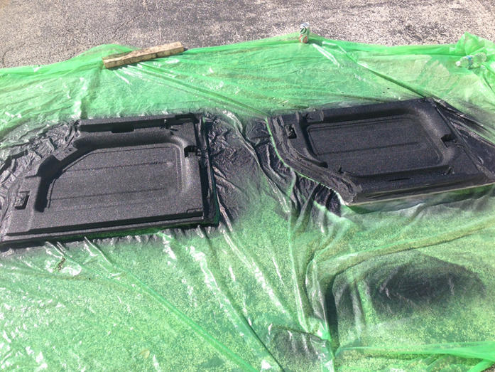

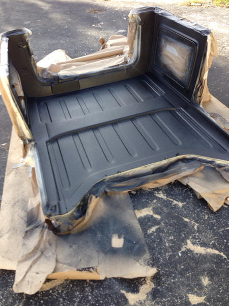

I raptor lined my front and rear hard tops

Hey Spencer, I have 2 kits of Raptor and was planning on doing the inside and outside of my top. Is there any fitment issues after you were done? And how much liner did the inside take?
Old Feb 19, 2014 | 08:19 AM
  #26
Spencer4336's Avatar
Posts: 616
From: Ormond Beach Florida
I haven't had any fitment issues I tapped off the weather stripping and the bottom of the hardtop where it rests against the body so the seals still work.
It took about 3 bottles to do the inside of the hardtop so I had 1 bottle left over in a kit.
You will have enough for inside and out with 2 kits.
