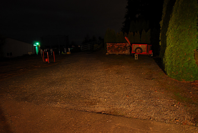

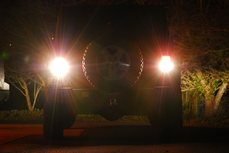

I just installed the 50 Watt Halogen replacement bulbs from JC Whitney as suggested by RedNeck and the new bulbs are noticeably brighter than the OEM bulbs.
Here is a pic during the install with a new Halogen on the left and the OEM back up light on the right:
and another taken from the rear with the upgraded halogen's light on the right and the OEM on the left of the pic:
I measured the output of the OEM vs. the upgraded halogen bulb with the spot meter on my DSLR at 10' from the back up light and the Halogen is just over twice as bright as the OEM. Nice improvement for 10 mins time and $25. Good call on the new bulbs RedNeck!
