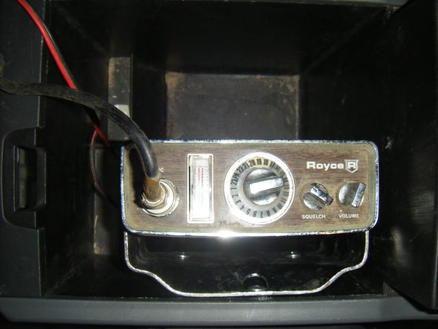

I bought a used CB radio for $10 without even knowing whether it worked. For $10, I figured why not.
The main problem was that it had its power cord cut and no mounting bracket.
I was going to use the amplifier mounting bracket from my CJ, but Indiana cancer made removing the screws more of a challenge than I was up for.
While scouring the garage for a bracket, I noticed I still had the ends that I cut off the metal part of my front bumper when I stubbified it. AHA!!!
The dimple in the bumper end made a perfect offset to angle the bracket.
I drilled a 1/8" hole and a 1/2" hole, centers about 1/2" apart. (3x, in a triangle pattern)
I used a dremel burr bit to extend a slot from the small to the big hole.
To ease installation and removal of the bracket, I used a ball-peen hammer to flatten the transition from 1/2" hole to slot.
I drilled holes in the side of the bracket to mate up with the radio mount holes. (not visible in this pic)
I placed the CB and bracket in the console so that the console lid could still close and the antenna wire would have clearance without kinking.
I marked the top of the top slot with a screw point, then ran a wafer head screw into the side of the console.
I removed the CB from the bracket, hung the bracket on the top screw, and marked the other two holes.
I removed the bracket and ran the other two screws into their marks.
I placed the bracket on the screws, then adjusted the screws so they held the bracket tight when bottomed out on the slots, yet still allowed easy removal.
I then removed the bracket from the console and re-installed the CB radio to it.
Slide bracket onto screws, verify proper clearance.
For the mic bracket, I had a spare support left over after installing a rotisserie to my gas grill. (bought on clearance at Meijer last year)
The slot in the bracket was perfect for the mic nub.
I mounted the bracket to the side of the console, using the existing bolt.
(I had to open up the slot in the bracket a bit so the bolt would install freely.)
The CB is protected from splashing mud and the mic is in a handy-dandy location when needed.
Since I put a cigarette lighter plug on the CB instead of hard-wiring it, installation or removal of the radio is a less than 30 second affair.

With the old Royce size, I had to open up the bumper channel quite a bit.
It also required a 90° adapter for the antenna connection.
On the first CB trip, I found I couldn't transmit. After a bit of troubleshooting, I found the transmit circuit had a fried transistor. I couldn't find a suitable transistor to replace the toasted one in my $10 craigslist bargain, so my dad hooked me up with a some of his "classics" from over the years.
