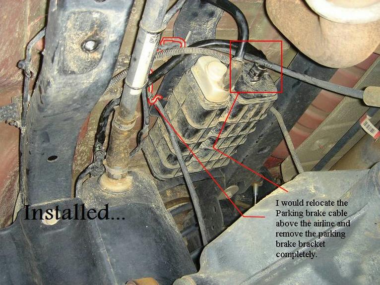

Very good work on thinking this through!
A couple changes I would make shown in the pic!
Good ideas. If I get no ck eng lights when I flip the bolt I may do that. The way it's routed keeps tension off the hose since it's semi-ridged tubing it's pre-bent. Now that it's hung I can mess with the hoses. I was considering the e-brake bracket. I may take it off and see how the cables hang. Good ideas.
Thanks for all the inputs! I rerouted the e-brake cable and removed the hanger assy. The cable sets more naturally. Flipped the bolts and locktited them again.
