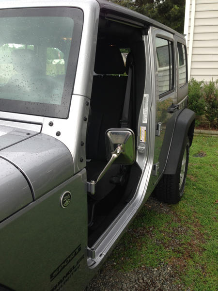

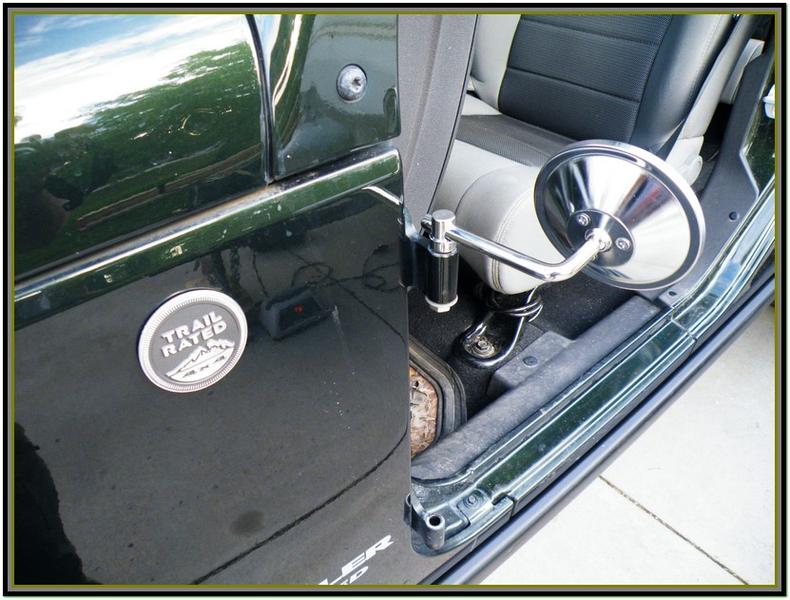

This worked really easy! only $15.00 at local MX shop.
Bikemaster motorcycle mirror part 60-0006Click image for larger version

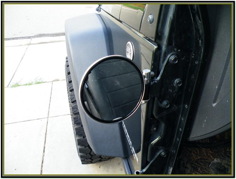

I did the budget mirror mod. I later painted them with bedliner paint.

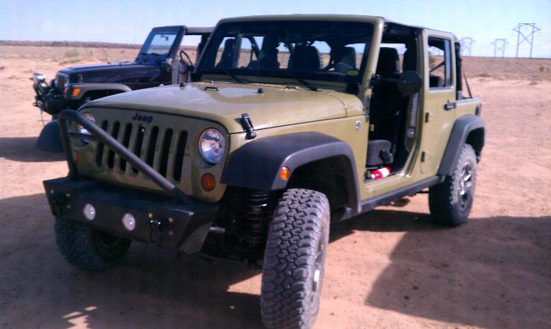

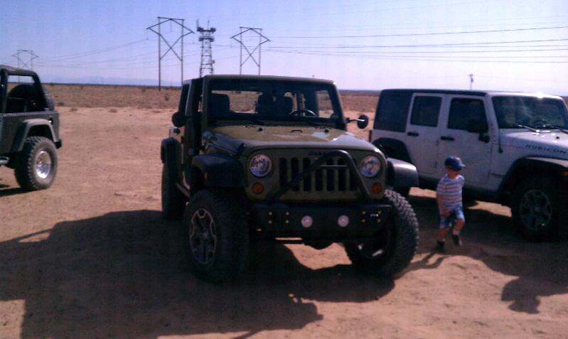

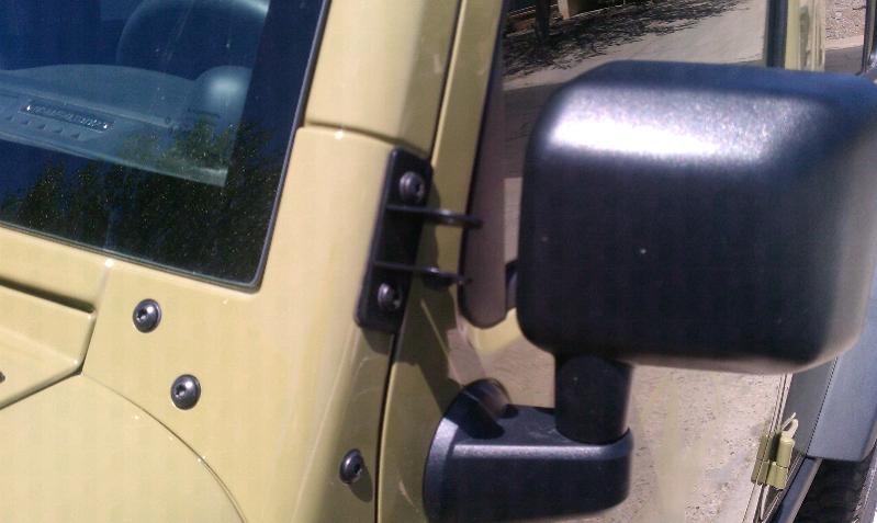

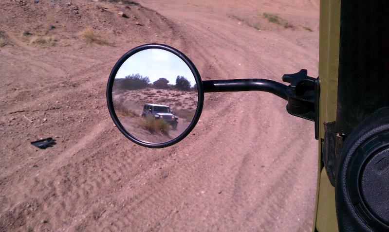

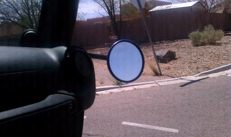

I ordered a couple of the rugged ridge relocation mirrors a while back. I wasn't happy since they were only designed for one side of the jeep so you would have one up and one pointing down. I chopped the adjustment ends and laid them on my bench to get a better alignment then I redrilled the holes. Sprayed them flat black and I'm now very happy.
Someone had some questions so I thought I would post the picks I had.
I have the exact same mirrors. After 2 years the metal is starting yo crack from vibration.

Originally Posted by WAT3RDOG
I'm running the rugged ridge exterior mirrors (that I had to slightly modify) and spot mirrors on the dash in order to see those dirt bikers that sneak up on you in the desert.
Attachment 480579
Attachment 480580
Me too. Inexpensive, easy and they work great.
