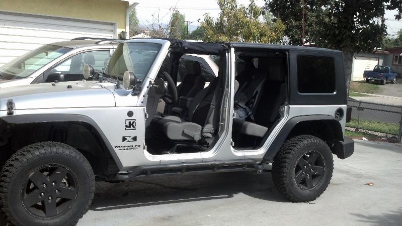

Got them for 20 bucks both at pet boys

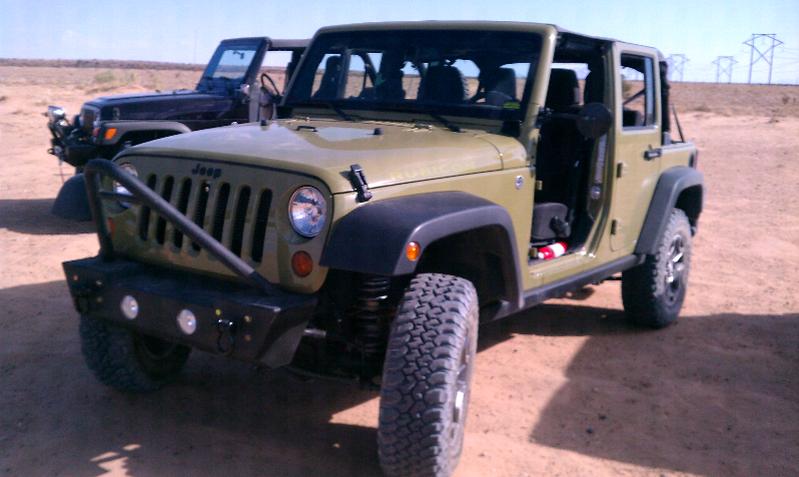

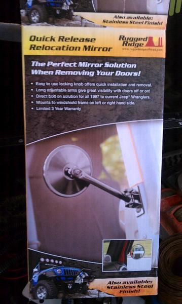

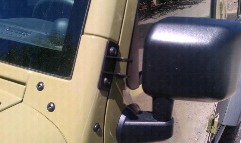

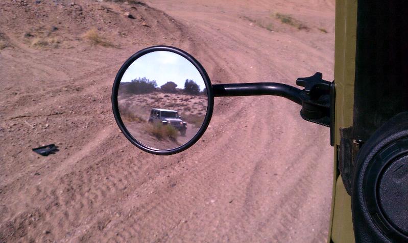

I ordered a couple of the rugged ridge relocation mirrors a while back. I wasn't happy since they were only designed for one side of the jeep so you would have one up and one pointing down. I chopped the adjustment ends and laid them on my bench to get a better alignment then I redrilled the holes. Sprayed them flat black and I'm now very happy.
Someone had some questions so I thought I would post the picks I had.

Thanks again man mirrors work great
