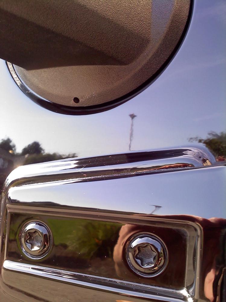

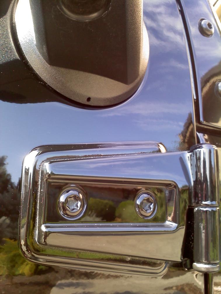

I was going nuts with these white drip lines. I'm a member on a detailing forum and was asking those guys on product recommendations for removing the mineral buildup. Pretty funny... but I was pointed back here for this solution.
Great Idea! I used a 1/8" bit.
I actually took my mirrors off to polish the doors with my Porter Cable 7424 and also to see what was inside the mirror. I took a pair of scissors and cut a small "V" in the bottom of gasket to ensure that the water would drain out.

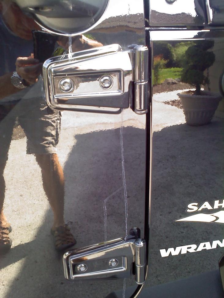

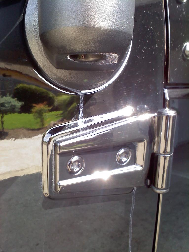

These were what my white mineral drip lines looked like before:
ID:	27660   Click image for larger version
