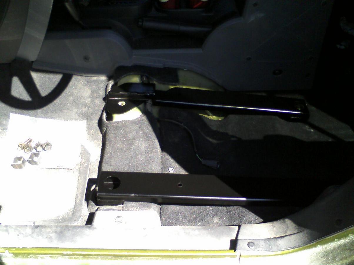

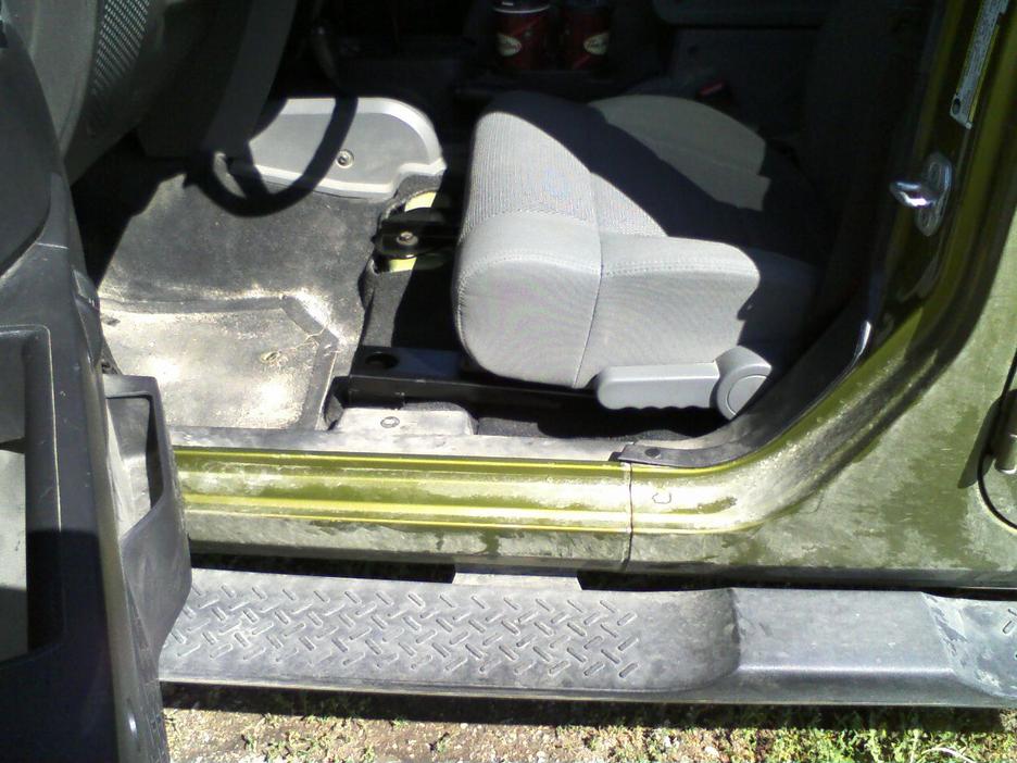

A couple of weeks ago I noticed that my son's driving position in his JK was dangerous.
Let me explain, He's 6'4'' and with the seat as low as it would go, the back of his head would hit the roll bar in an accident .
Here's what I did,
I made new seat brackets to replace the factory ones.
I lowered the seat 2.5 inches and moved it back 2 inches.
Also I rasied his head rest 2 inches.
I have attached some pictures for any other tall guys out there to see how it's done.

Do you happen to have any drawings for the new brackets? I have no chance to make them myself, so I'd need blueprints to take to a local machine shop.

Please don't take offense, but this sounds like an incredibly bad idea.
"A couple of weeks ago I noticed that my son's driving position in his JK was dangerous."
With respect: Is this based on analysis, or observation and opinion?
A lot of design engineering goes into seating position and human factors analysis. Fabricating your own brackets away from the factory design changes the load paths of forces in an accident.
Simply changing the angle of the seat could possibly induce fatal g loading onto your body in an accident by increasing the force transmitted through the frame to the new brackets. The seating is designed to be as survivable to the occupants as possible in an accident.
Also, did you use an equivalent or stronger material for your bracket fabrication? Does the heat treatment on the material grant the same properties as the original material in elasticity and strength?
Look, there is a reason things are designed the way they are. Please just make sure you are not taking an unnecessary risk just to increase your ride comfort!
