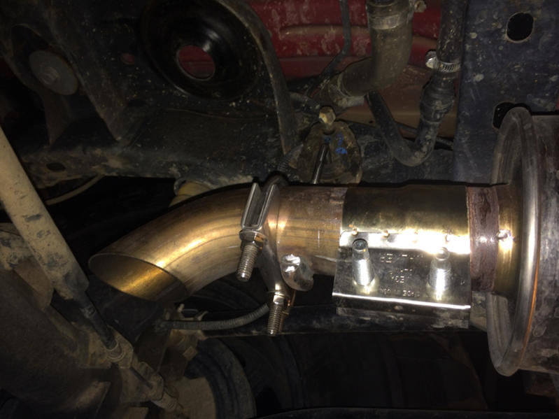

The Dynomax cat back turn down (39516) is only offered for a 4 door but will work on a 2 door with a few modifications. I chose this exhaust system for a few reasons I had to have a turn down due to my rear coilover setup, the price was great, and I don't trust local shop for custom work. For the modifications I had to do is trim the turn down after the muffler 1.5" then I used this adjustable hanger http://www.lmperformance.com/67163?g...FcRAMgodHB0A3A to use the factory hanger mount. The exhaust has very little cab drone if any. And is quite at normal speeds but has a nice deep ton if you get in the pedal. I'm typically not a turn down person but I'm really satisfied with the setup. And the dynomax rep on here is outstanding on service.

I did the same setup, I think with the same muffler even. Its been on there for about a year but had a local shop install it all for 60 bucks
