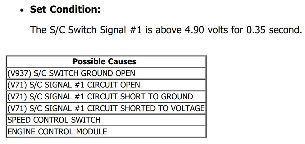

Looks like an open ground wire connection (V937) from the speed control switch -- Deduced from an open connection on ground wire circuit V937 being the common cause for both DTC's.

Here's the schematic...

Thanks for your help, Mr.T! I really appreciate your reply but that’s too technical for me, I am afraid :( So, which part am I supposed to exactly check please?
