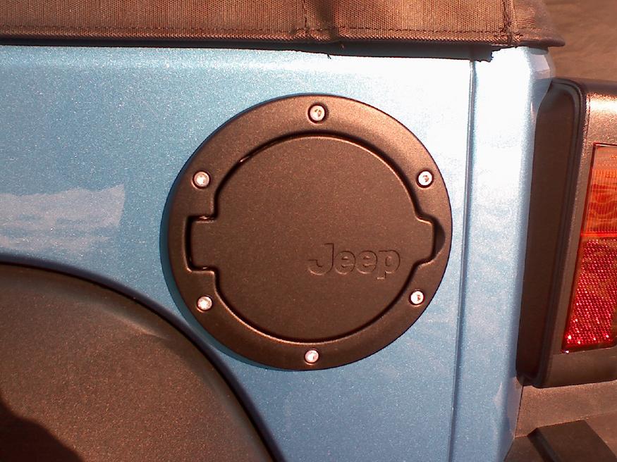

Thanks for the write ups guys. Went pretty smooth.

My first mod. MOPAR fuel Door.
All I can say is,, what a pain. You would think something from MOPAR made for one of there vehicles would fit better. The install is straight forward but it ends there. Getting the old housing off was not to bad, but putting the new housing in for the fuel door was a bear. The two lower clips went on ok. There was no way the upper push clips were going to seat right. I had around a 1/16th of an inch of the upper clips what would not push behind the sheet metal. And this is with the housing’s collar pushed flat to the sheet metal.
To make a long story short I used my grinding tool and I took off around a 1/16th of an inch from the upper push tabs on the housing. Well look at this it fits ,,Hurray, And only after 1.5hrs off getting pissed. I still have a very small gap between the housing and the sheet metal, the thickness of a piece of paper but it’s tight. I’ll wait for some warmer weather and put a small bead of RTV around the top of the housing ware the gap is. No dig deal.
