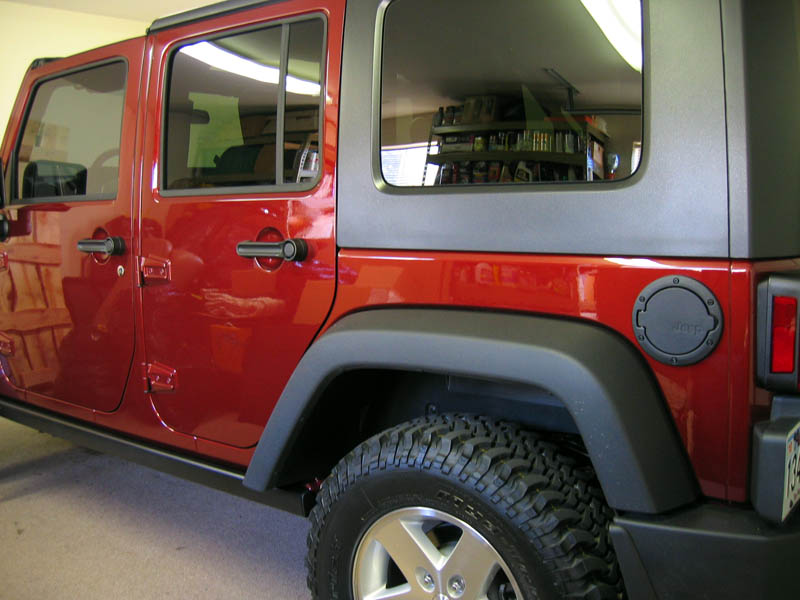

Old Mar 1, 2007 | 01:33 PM
  #37
tolh13's Avatar
Joined: Sep 2006
Posts: 344
From: lake worth fl
here what it looks like.
Old Mar 1, 2007 | 04:50 PM
  #38
RedRockJK's Avatar
Joined: Feb 2007
Posts: 1,313
From: Arkansas
Here's mine with the custom screws. Thanks again John!
Old Mar 1, 2007 | 05:49 PM
  #39
John L's Avatar
Joined: Feb 2007
Posts: 465
Those look great guys!! Thanks for the pics!
