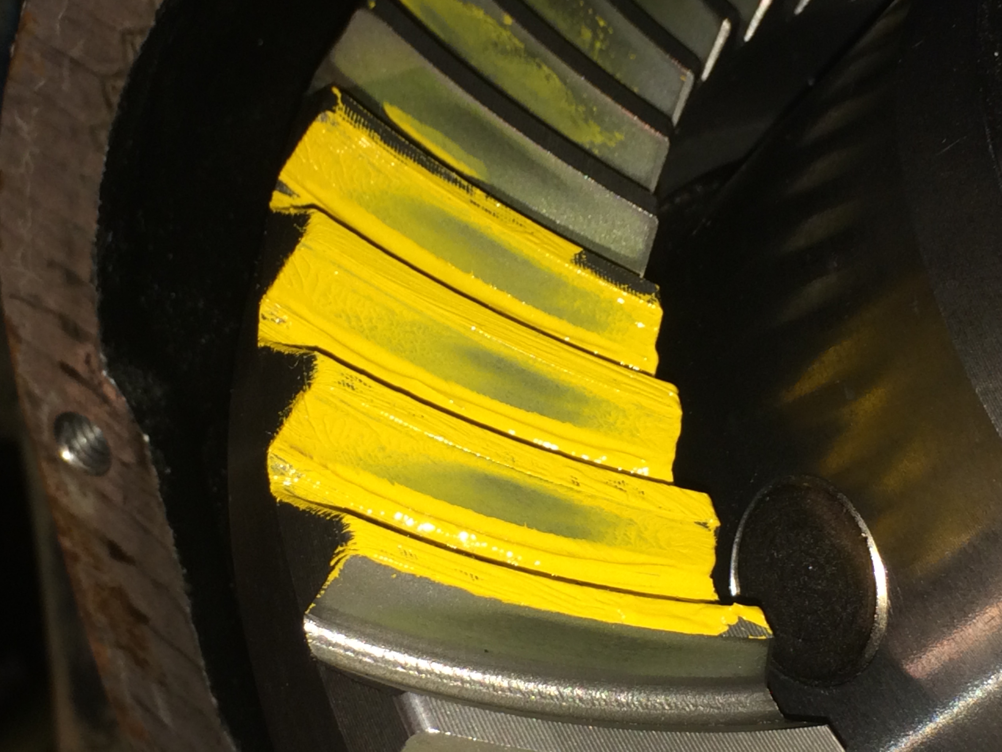

I just finished the gears in my Dana 44. All went well up until final assembly when I torqued down the pinion nut. I went showly until I got to 25inch pounds on my beam torque wrench. But as I spun it around, I noticed a 45 degree spot where it increases to 35 inch pounds. The increased drag comes on slowly, stays constant for a second, then slowy dissipates. There’s no binding, no grinding, but it is noticeable.
It didn’t do this with the setup bearings, only the final bearings.
I checked the outer races after I installed them during final assembly with a feeler gauge. Even the thinnest one never even hinted at going behind the race in any of four quadrants I checked, so I KNOW the outer races are fully seated. As for the pinion inner bearing (I watched the shop press it on myself, there were no problems and it seated fine with him applying some extra force after it seated just to be sure. And it was pressed on via pressure to the inner race only. Once on, it spun freely.
Thoughts?
Should I be alarmed, or go ahead and throw the cover on?
Someone PLEASE reassure me...
