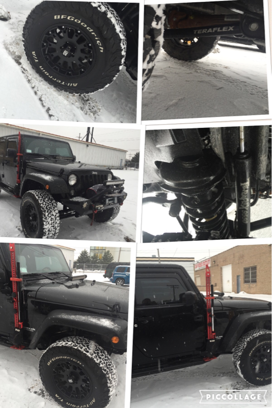

I have a question, I have 3.21 in my jeep jku. I'm trying to regear in the near future. I want to go 4.10 or even 4.88. I want to know if I can just get a ring and pinion set for front and back or will new axles and etc have to be replaced with the new gearing. Thanks ahead of time btw it's a 2015 jk with 3" teraflex lift and 35s

4.10 or 4.56. Personally I would say 4.10 would be perfect if you do lots of highway. And you just need new ring and pinion. And you will need new carriers to. You should upgrade and put a locker in the back at the same time no extra labour to install
