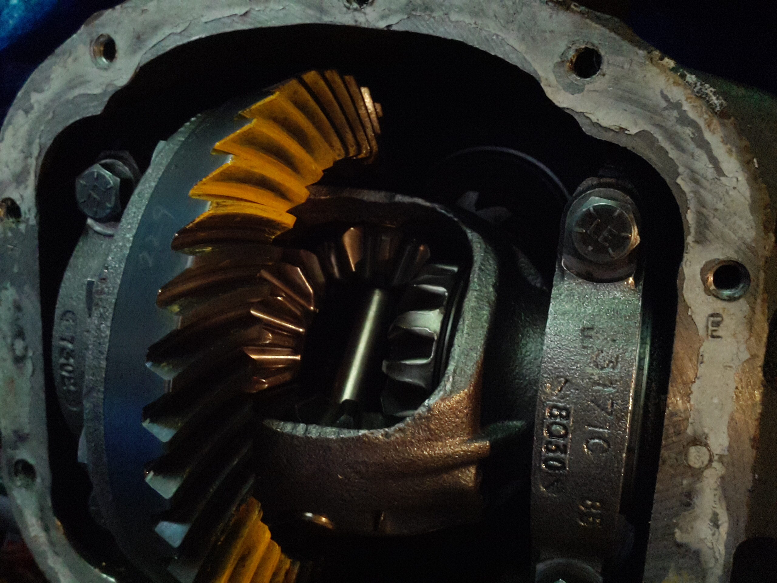

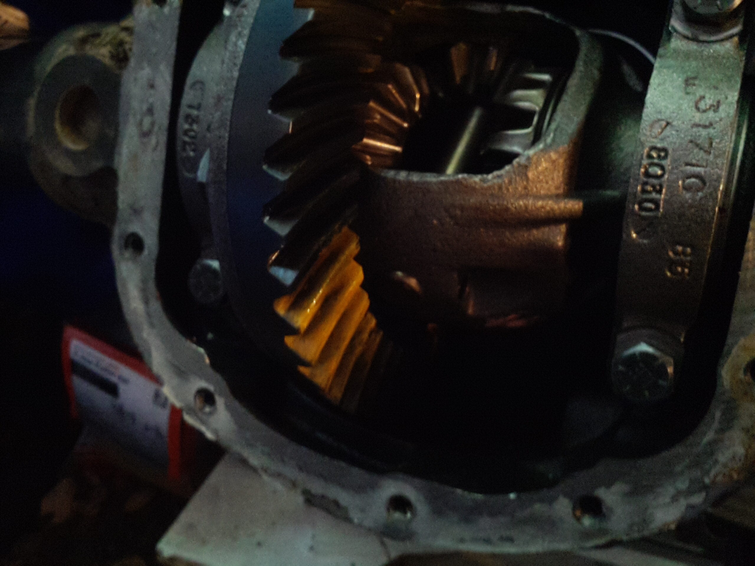

I did my rear install 2 weeks ago, and today I drained the diff for the 500 mile break in. just wanted some opinion's on my pattern before I do my front gears.
here is the patter when I set it up:
these are the pics from today at 500 miles:
Any thoughts? will they survive?
