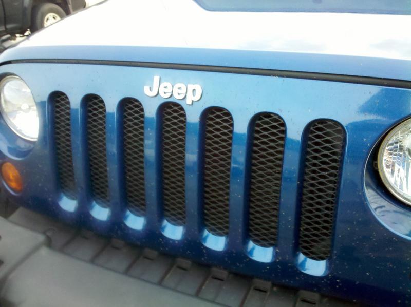

Glad this topic is still goin. It helped me out. Here's mine:
Supplies from Home Depot:
1 Spray Can
2 Bags of Tie Blocks
1 Bag of Zip Lines
1 Gorilla Glue
2 Sheets of Expanded Aluminum
All came to ~$30
Sprayed it up. Cut an extra piece since the one pre cut is a tad bit short.
Get the tie blocks and zip lines together. Added some Gorilla Glue under the tie blocks and around the expanded aluminum. Gave it about 30 minutes for the glue to sink in.
Viola!
Finale!
Thank you guys =)

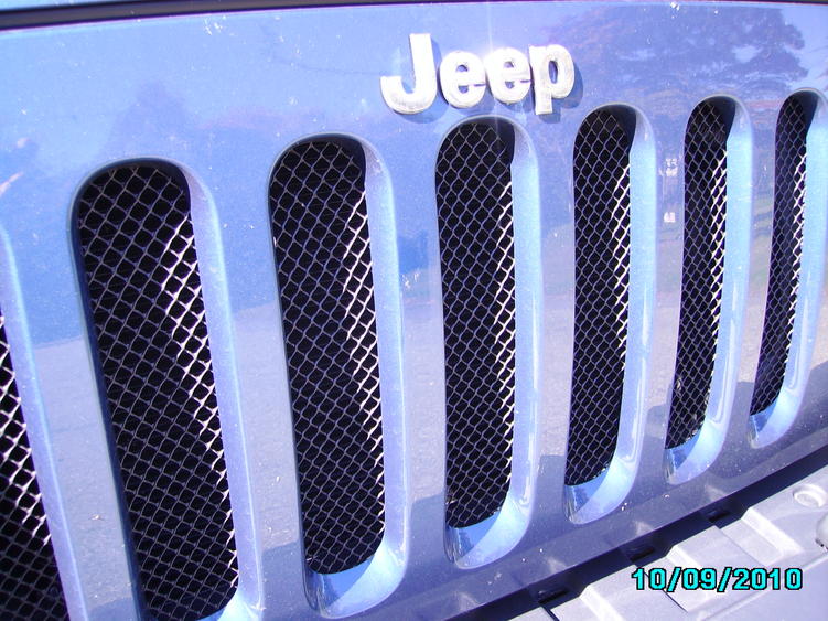

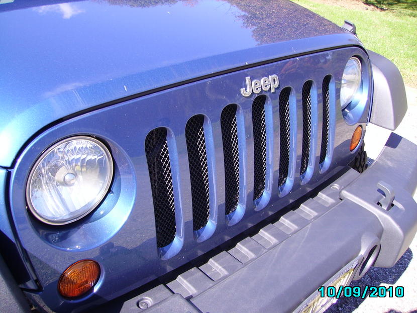

Finally got around to uploading some photos.

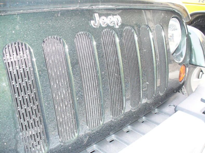

Did mine over the weekend... used the plastic 'gutter guard' from Lowe's:

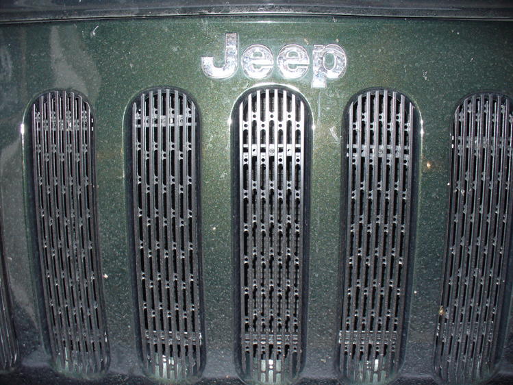

Thought I would do the grill mod as long as I was doing the trans cooler update. No Home Depot or Lowes close by for expanded metal so used a 36" aluminum screen door protector from Menards. Cut it 14 1/4 tall by 28 1/2 wide. Used tye straps and these clips from super glue to hold on. Had the mesh in dark bronze aluminun so i left it that color with the Mango. Just another variation.

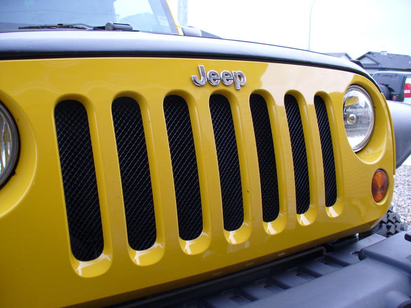

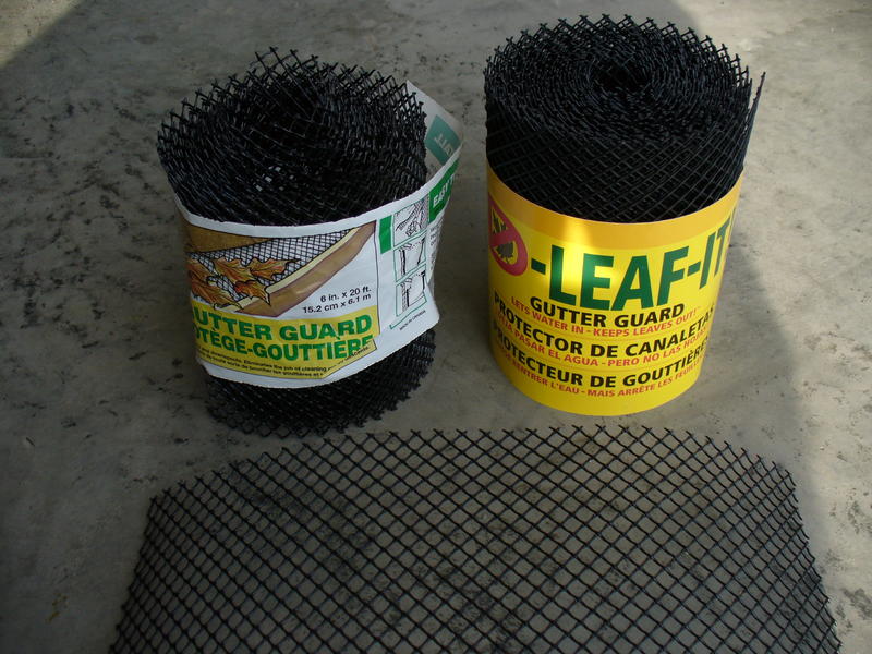

I did this mod today with some Gutter Gaurd, (there are 2 rolls of gutter gaurd in the pics, one from Home Depot and one from Rona, I went with the one on the left from Rona because I liked the look of it better)Click image for larger version
Sorry, pics aren't best quality:Click image for larger version
ID:	97535Click image for larger version
Total cost was under $20.00.(not bad when you compare it to the $100.00 one I put on my wife's Sahara before I saw this post).Click image for larger version
ID:	97537Click image for larger version

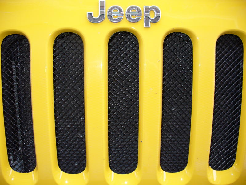

Completed this one myself ... bought a piece of steel for $5, cut, sanded, primed, and bedlined it and attached some zip ties with epoxy similar to what was done here.
Turned out pretty good, blistered the ends of my thumbs pulling off the backing on 40 of those zip tie mounts, but well worth it for the look.
