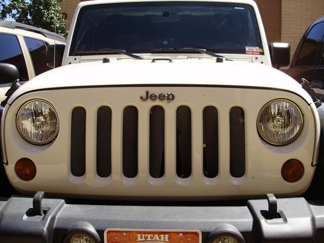

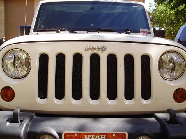

heres mine. screwed up and cut a piece wrong, (it was one of those alum kick screens, painted with rubberized under vehicle paint, turned out GREAT) and one slat has diamonds facing the wrong way. lol i gotta take the grill off this week to install a hood lock anyway. im still trying to fab something up that allows me to unlock it without having a hole in the mesh. maybe a secret spring loaded cable in the fender. i dunno yet. anyway heres pics. if i didnt screw it up (was at work, so i had to rush it) it would be perfect. attached with 1x1inch tiedown blocks, with double bubble. the white specks in the last picture are just from the rain. edit: damn sorry new iphone 4 takes gigantic pictures lol

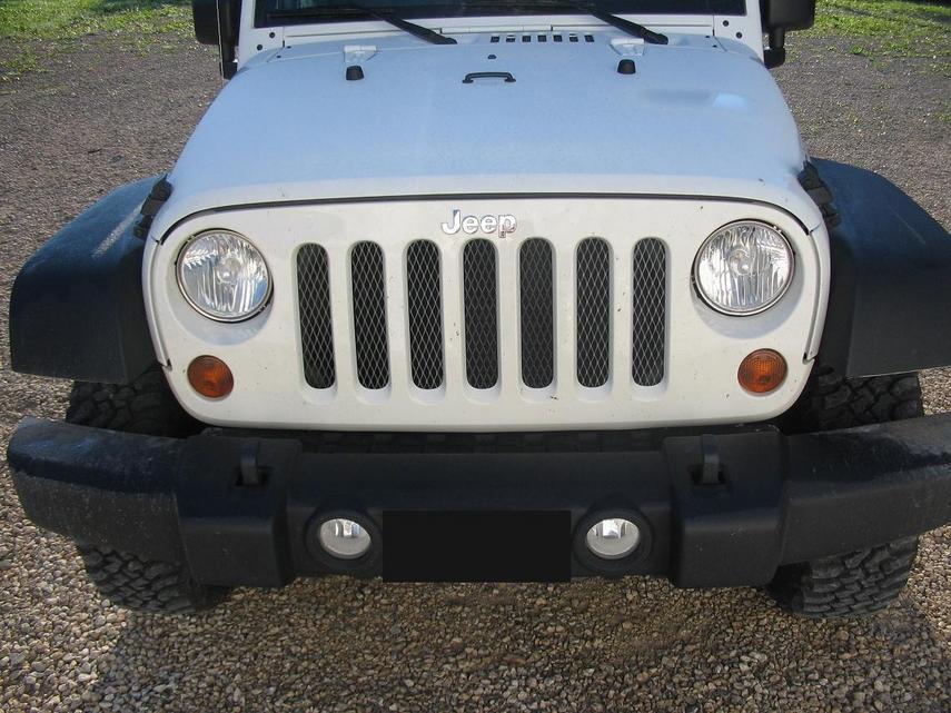

Default I have finally did it!!!!

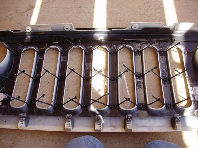

My first "do it yourself" mod!
I have follow "brattwurzt" idea (see his post!) tone of credit! THANK YOU!
I did this last weekend, works great, easy to clean and maintain!

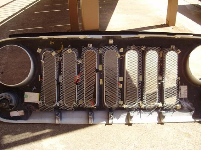

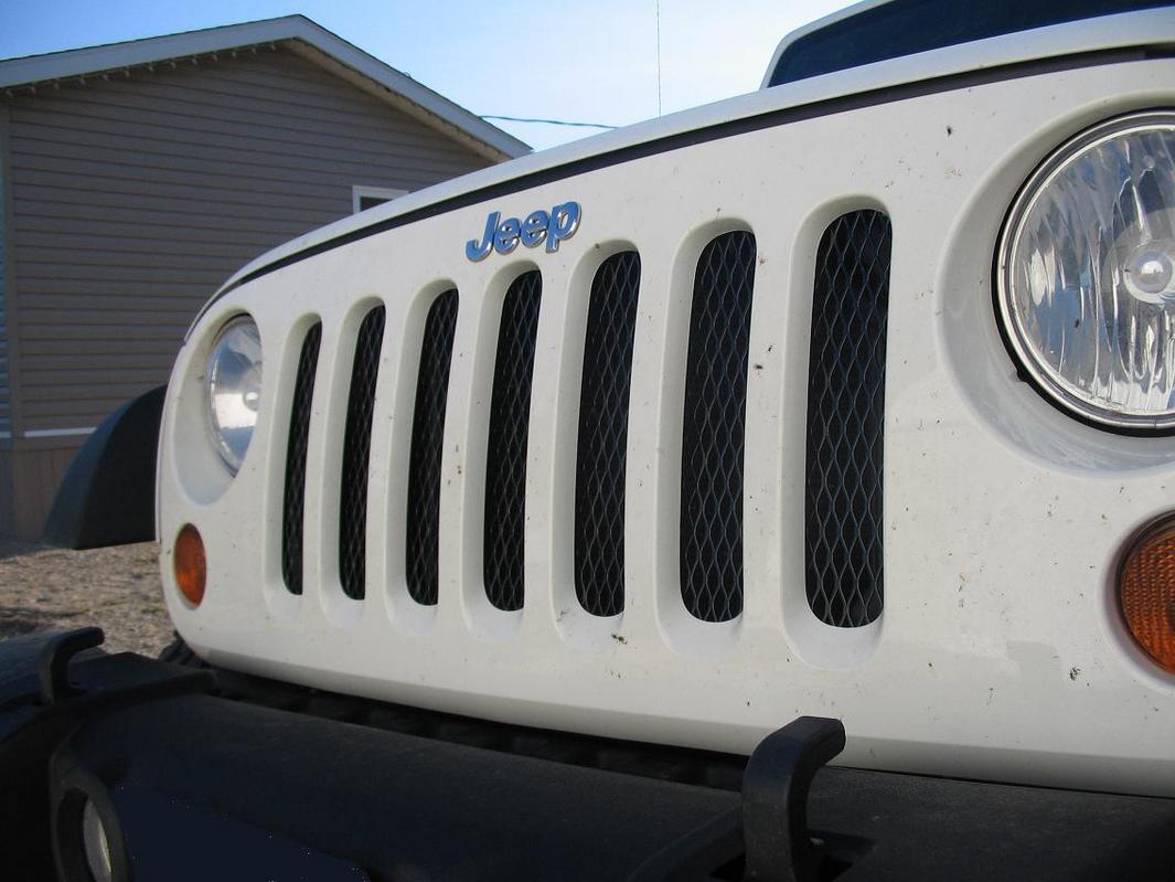

Got mine done this weekend, been kinda lazy with uploading the pictures tho. I went with the expanded aluminum because as you'll see the person who owned the jeep before me tried to do it with that screen mesh stuff and jacked it all up. I figured it'd be worth the effort to get it done right.
That's what it looked like before.
This was the back side of the shoty job. As you can see it was done in seven strips and the blocks didn't hold at all.
This is after I've removed the screen mesh, and all the blocks that were still stuck to the grill. I used J.B. Quick, to attach the new blocks.
After I've attached the expanded aluminum.
Final product. Looks much better than that screen mesh stuff. Plus this will actully stop a rock when it hits the grill. The spots in the bottom left and top right are where the paint was still wet when I flipped it over and sprayed the other side, I'm gonna mask the grill and fix those this weekend.
In my opinion go with the expanded aluminum instead of the mesh. It may be harder to find and possibly a little more expensive, but you'll get out of your jeep what you put into it.

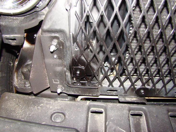

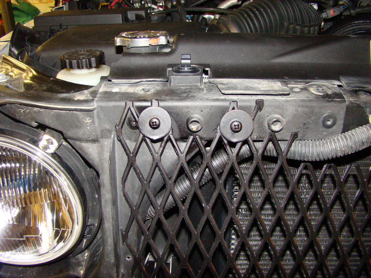

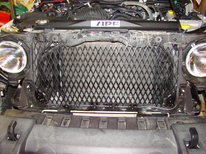

I attached mine to the shroud around the radiator with stainless screws and washers instead of trying to figure out how to securely attach it to the grill. Looks great.

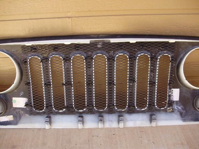

Glad this topic is still goin. It helped me out. Here's mine:
Supplies from Home Depot:
1 Spray Can
2 Bags of Tie Blocks
1 Bag of Zip Lines
1 Gorilla Glue
2 Sheets of Expanded Aluminum
All came to ~$30
Sprayed it up. Cut an extra piece since the one pre cut is a tad bit short.
Get the tie blocks and zip lines together. Added some Gorilla Glue under the tie blocks and around the expanded aluminum. Gave it about 30 minutes for the glue to sink in.
Viola!
Finale!
Thank you guys =)
