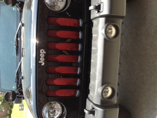

Originally Posted by towel33
Here's red inserts on black I did last week, black jeep already so didn't do the bedliner.
Attachment 276709
thats pretty slick! mine is black also so no opportunity to do the cool bedliner mod..

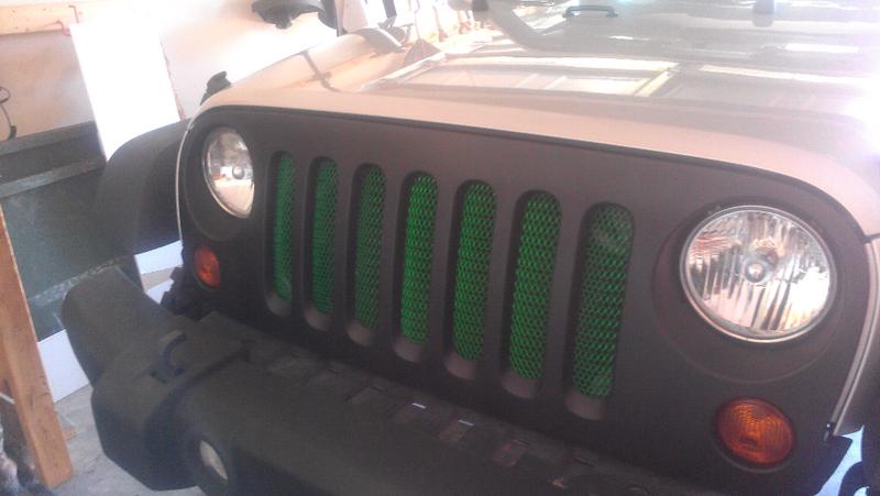

Just finished mine.

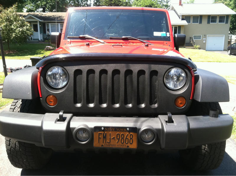

Couldn't wait to do this once I saw it! It turned out awesome.... I think at least. How has the bed liner help up washing it?
