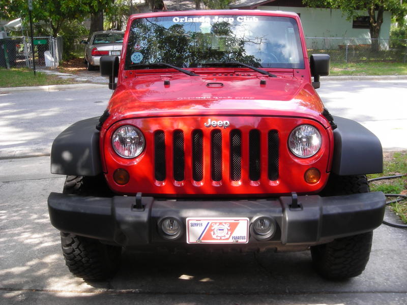

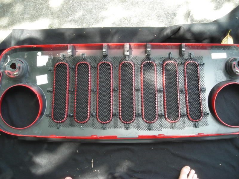

Did mine today. Used plastic gutter guard from lowes. 1x1 zipp tie blocks with vht tape
