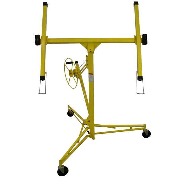

Where is your progress on that design?
Looks kind of like a drywall lift...

I like the "drywall hoist/lift" idea, but you'll still need a place to set the top (I don't think I'd want the pressure points to stay in the ceiling for extended periods...)
But that would take the pressure off your back!

I guess my only thing with the original design that you had is the fact that a lot of tops are painted now so we would need to cover it with something that would protect the paint on the new hard tops....
I like your idea, I do but I think I need to modify it just a little.

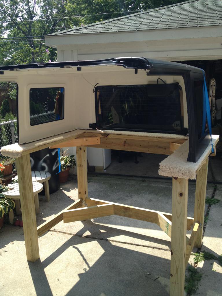

Finally got to do this! It was so easy. It took me 8 minutes to take the top off and I was being extra careful. I'd say that's a success.
I built the table as suggested but added eye bolts for a strap.
I'm happy with this setup, it's great!
