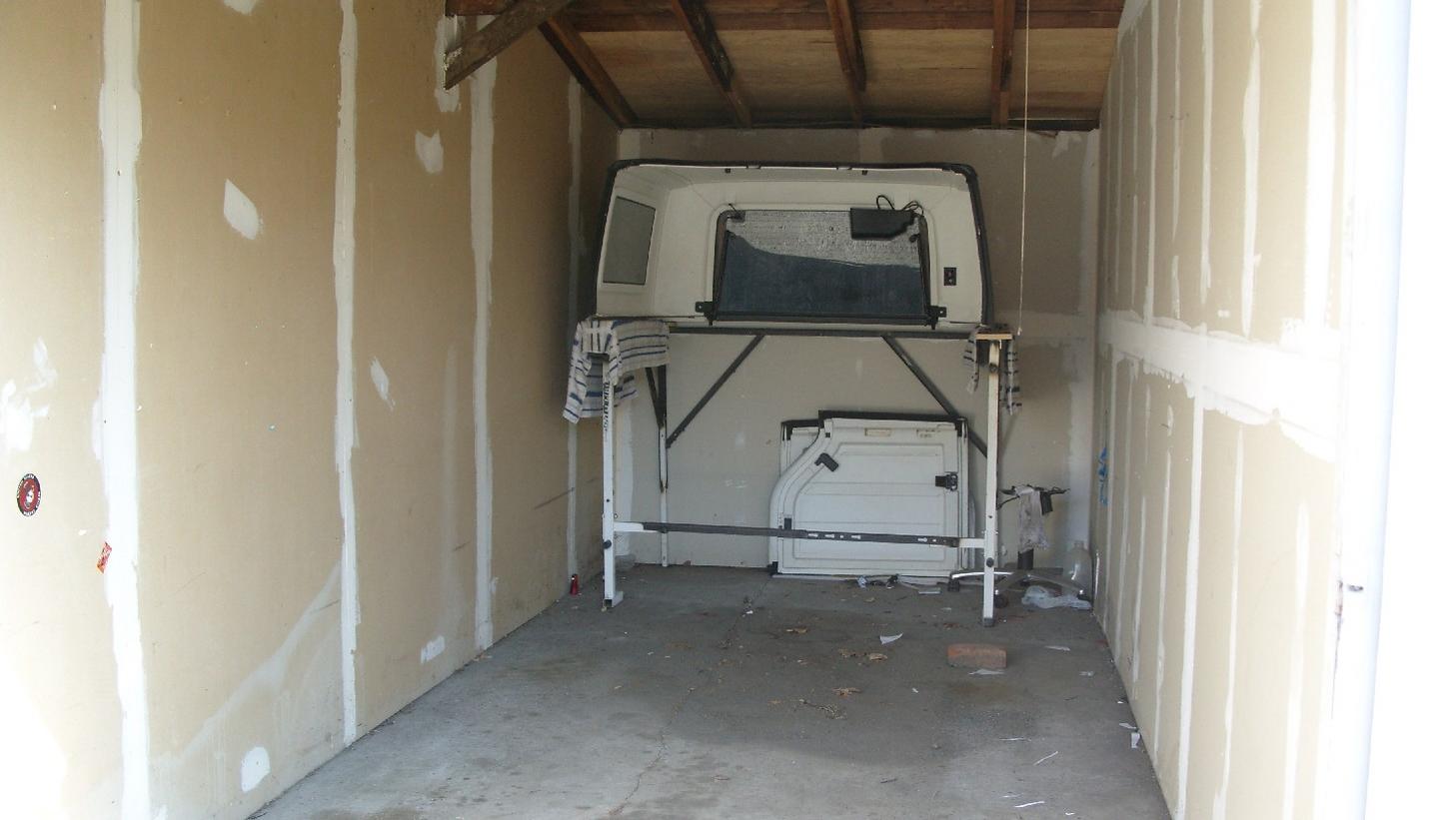

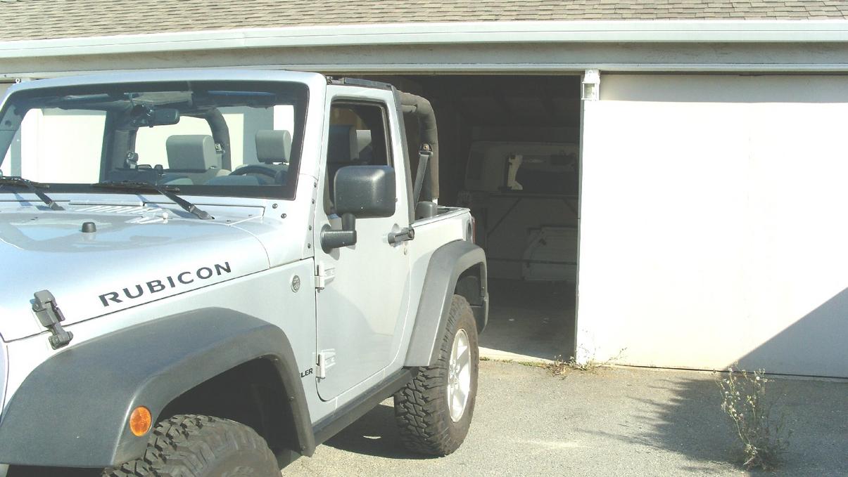

This forum/ site is awesome. sharing information techniques, helps us all.
i made my own one person hardtop removal thingamajig.
My neighborhood had a spring cleaning... i found this bed frame and a exercise gym equipment.
i cut and welded it together, bought 2 pieces of wood, and wala, made my hardtop table.
I backaup the jeep, like i normally do, unscrew and slide the hardtop backwards. The jeep and hardtop fits in the garage coincidentally.
this whole deal only cost me the 2 pieces of cheap wood!
thanks again,
jason

This is a great thread that really got me thinking. The "MODS" I would add are to make the rig an inch higher so that you could leverage the top off the Jeep quicker and intergrate storage underneath to hold the removed doors.
