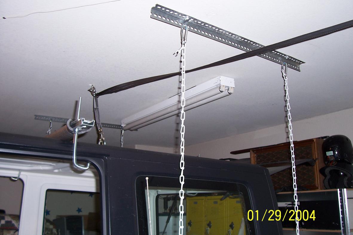

here's mine.. it took a weekend to do because my power tools weren't here. cutting by hand really itsn't fun
don't look at the date stamps, the camera was losing power and acting up

Originally Posted by btomike
Thanks for sharing. I'm not sure what the rating is on that chain but it looks like you may want something a little more heavy duty

the chain is rated for like 300lbs.
it is playground chain, works great. held me up on the wood and i know i weight more than the the top.
