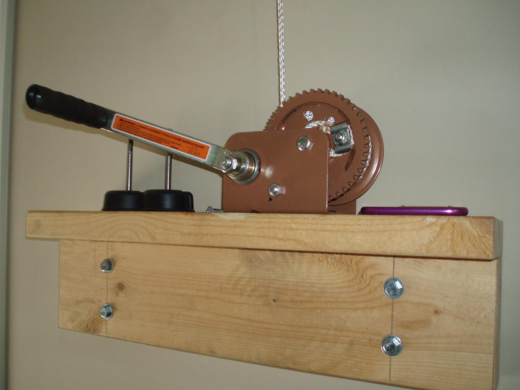

I used the same Winch from TSC and it works great. Not to mention the price. I have'nt finished the shelf yet but here are some pics.
Thanks again to this forum and also to HG97TJ for the original write up.
Not sure why the click free will not work.
Nice work cam ....here are the click free pics:
