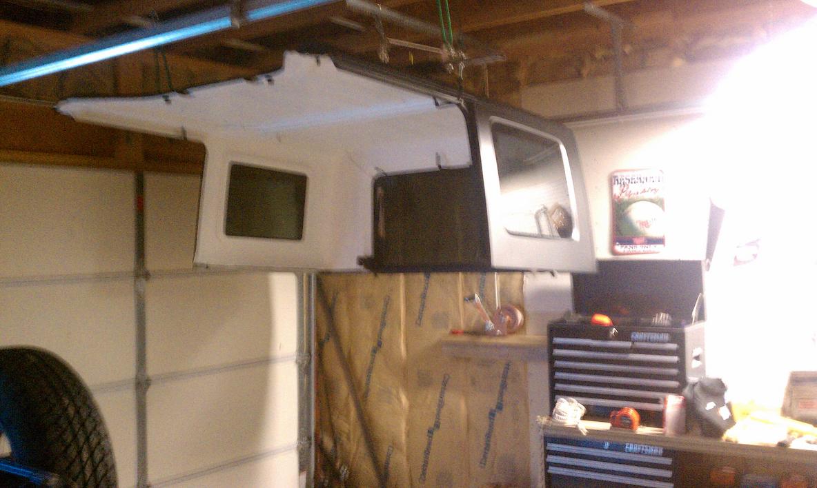

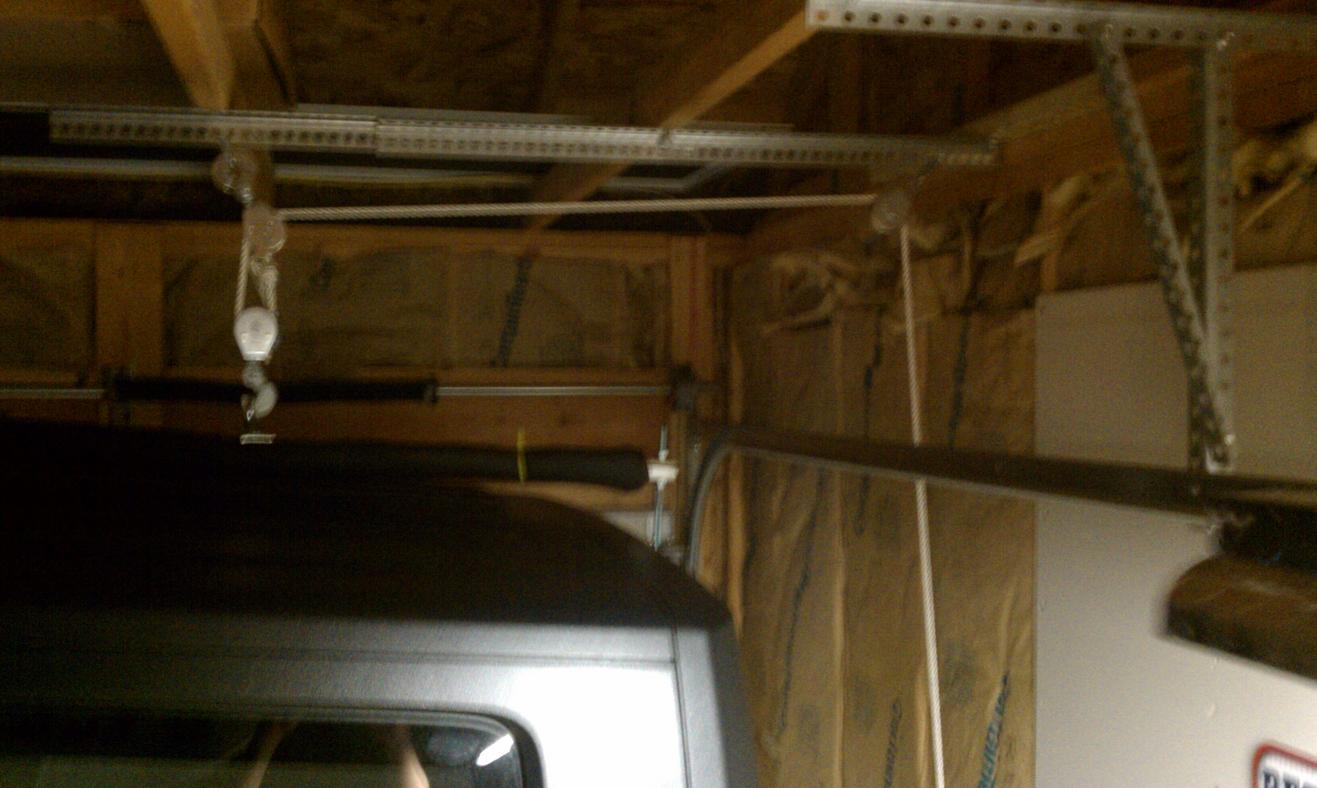

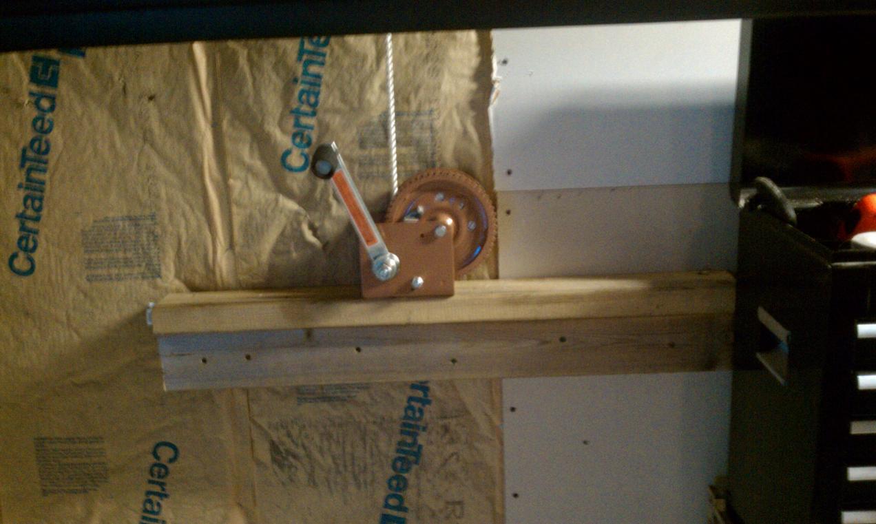

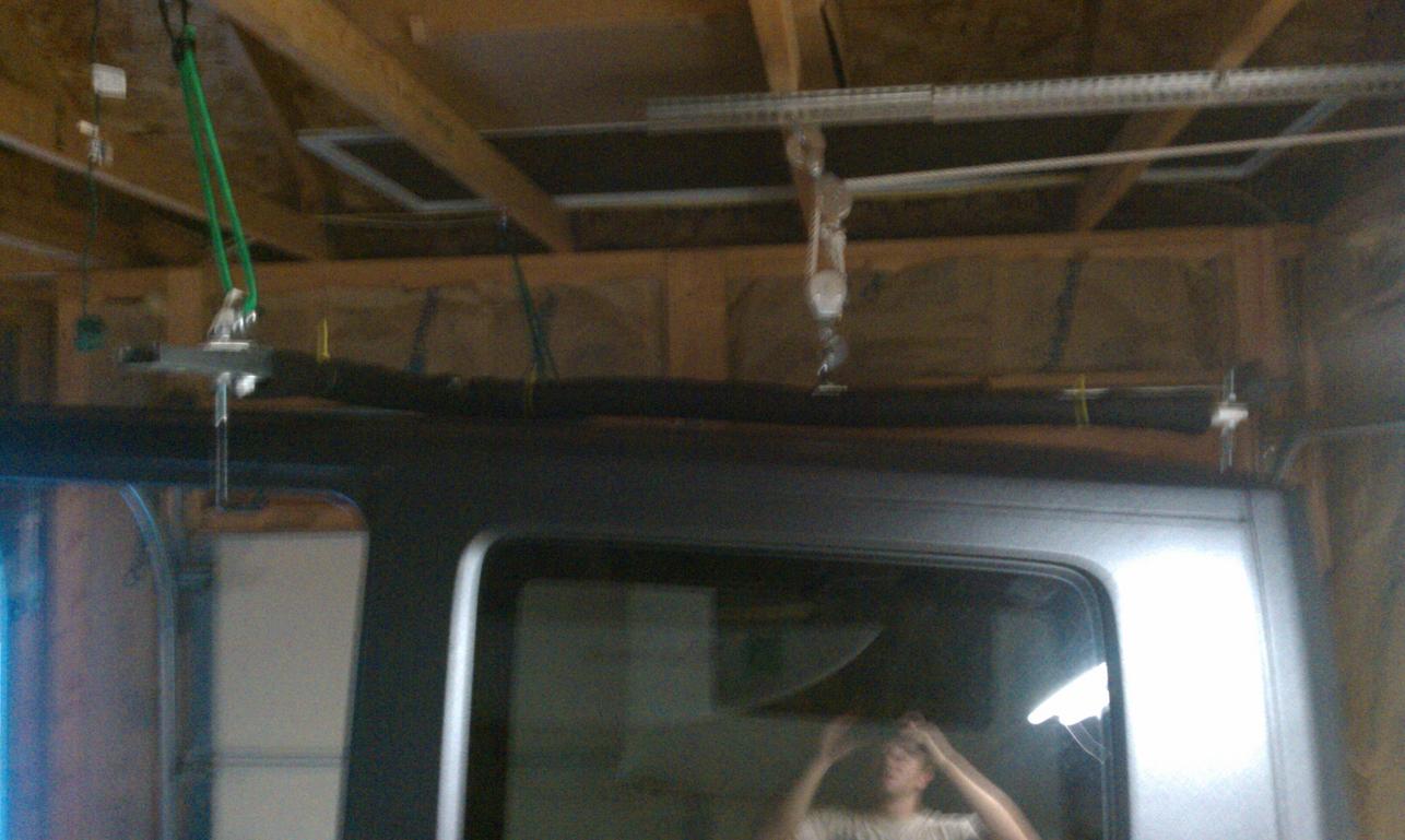

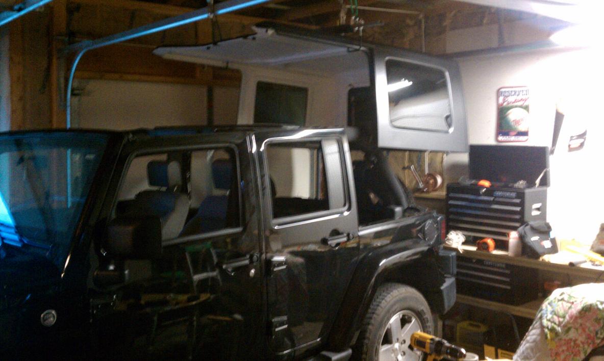

Default Here's mine
Thanks to everyone, especially the author of this thread, for this fantastic idea.
Attachment 81733 Attachment 81735
Attachment 81736 Attachment 81734
Attachment 81737
Your almost done...you need to put a platform under the top so the top can rest on it. If you don't the top will warp and you will find yourself with a leaky hardtop when it rains.
Cool, thanks for the advice. I had planned on doing that just for the sake of storing the front panels anyway but do you really think the top will warp? I live in Minnesota so I can only be topless for a few months out of the year and therefore wouldn't be hanging it for long periods at a time.
