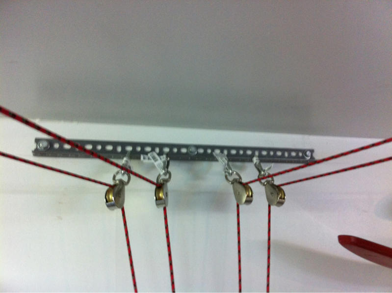

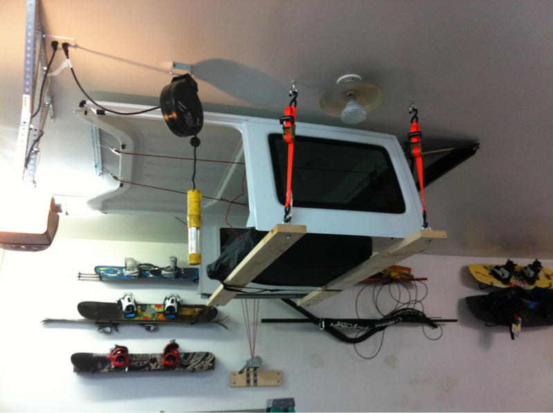

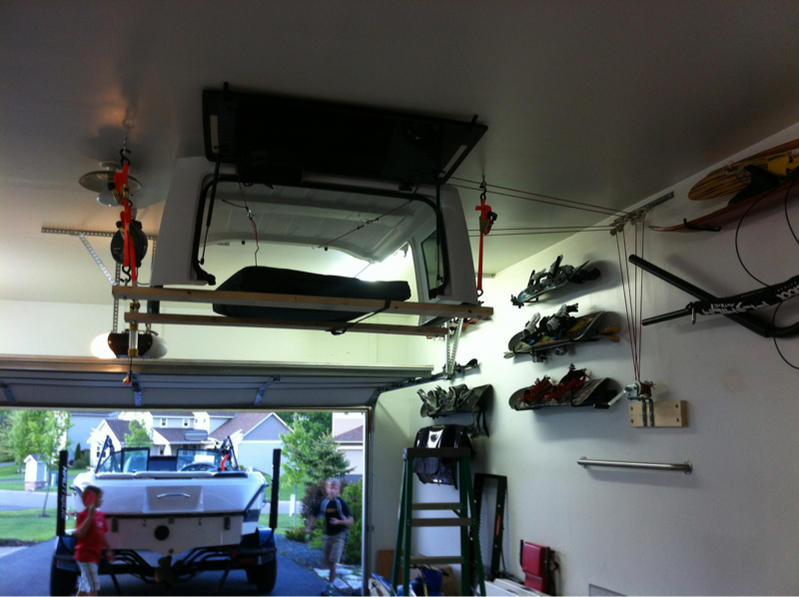

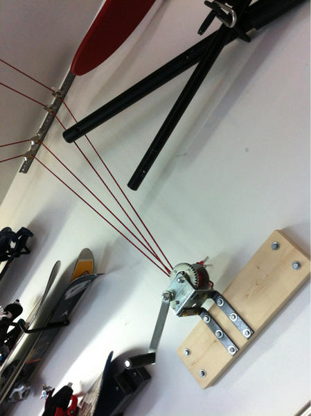

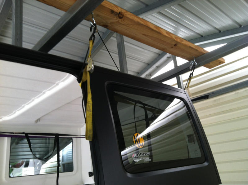

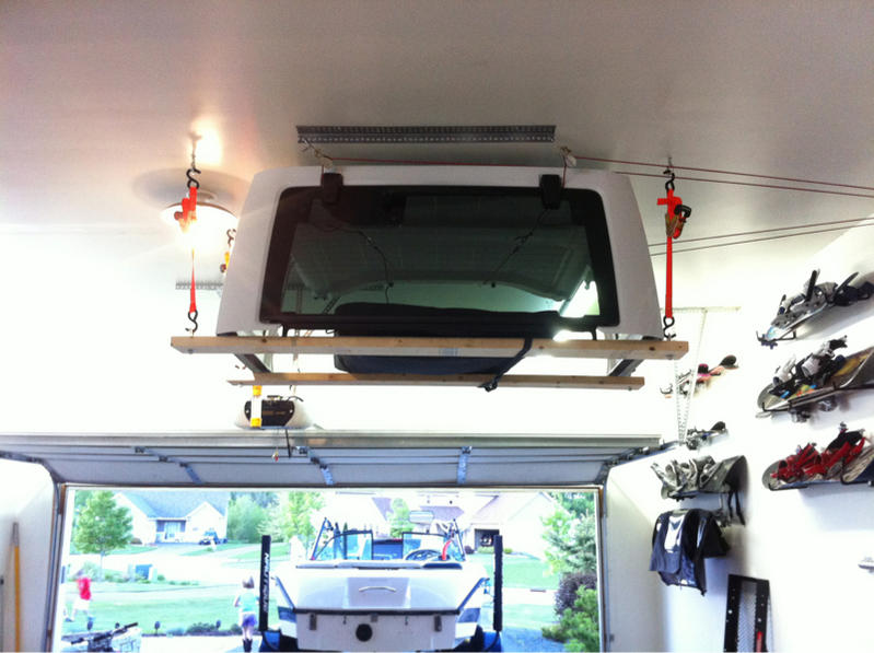

Finished up my hoist today, used the following parts:
All of this is from Menards (home improvement store):
Simple boat winch
100 feet poly line
8 swivel pulleys
12 Snap hooks
A handful of 3" long 3/8" dia. Lag bolts
2 angle brackets (heavy duty) to mount the winch
Then, just to be safe, and give me a shelf to store the two front portions of the roof:
2 2x6 boards 6 feet long
4 2" eyebolts with nuts and washers
4 3" lag style eye bolts
4 ratchet straps
The setup was simple, and it works great. The winch setup allows me to remove and install the top alone. It is secure (I have been using it for over a month now). I'm unsure of the total investment, but pretty sure I'm under $100 for the winch part, and about $40 for the secondary supports.
