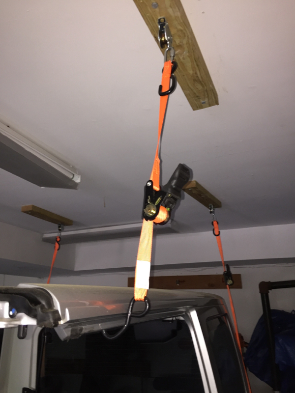

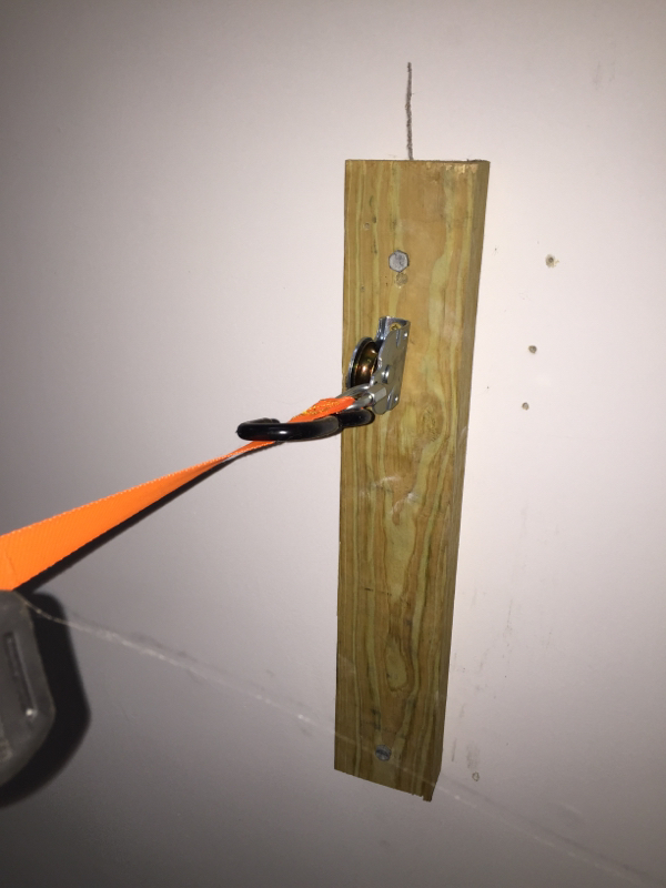

Mine is similar to a lot of what has been posted. Super easy install. Cut a 2x4 into four foot long pieces. Anchored the 2x4 into the ceiling joists. Planned on doing a pulley system but didn't have enough clearance so anchored four tie down into the pulleys. All I have to do is reverse into the garage ratchet the tie downs to lift the hard top off the jeep.
