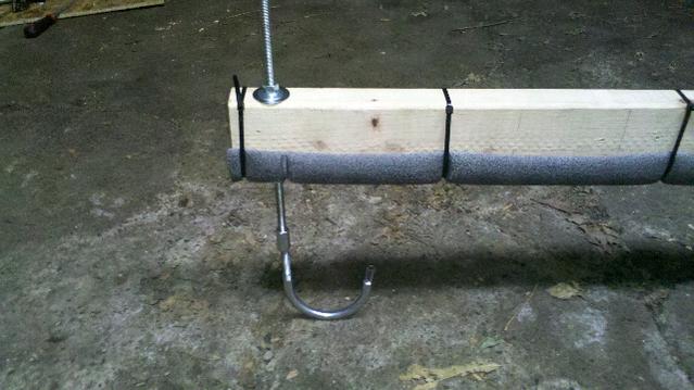

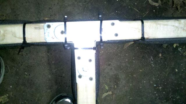

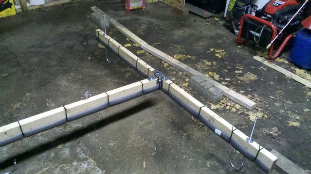

Old Mar 22, 2012 | 12:33 PM
  #370
TheDago's Avatar
Posts: 67
From: Rochester, NY
I just made something similar to the OP, I'll post more pictures and compete part list when it's competed and tested.
