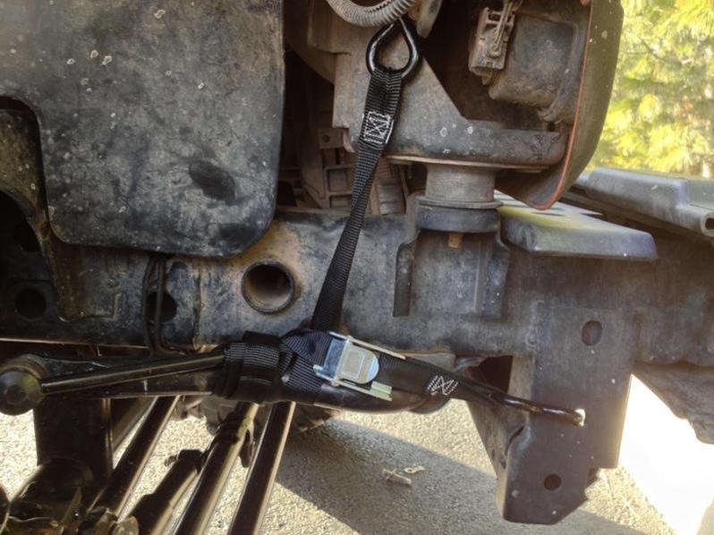

Originally Posted by JLsJK
I want to see a pix of how some of you guys are securing it when disconnected.. Please and thanks
I would like to see some pictures as well. Im thinking about getting this done over the weekend.
Old Jun 25, 2013 | 01:52 PM
  #106
kh202's Avatar
Posts: 3,142
From: Rockwood, TN
Here ya go
Old Jun 25, 2013 | 02:00 PM
  #107
mhockey9090's Avatar
Vet Army
Joined: Jun 2013
Posts: 1,287
From: NA
Originally Posted by kh202
I see. Have you seen or heard of other ways to secure it?
Old Jun 25, 2013 | 03:20 PM
  #108
kh202's Avatar
Posts: 3,142
From: Rockwood, TN
Zip ties. Sinch strap is quicker, easier and wont break. Bungie cord also works
