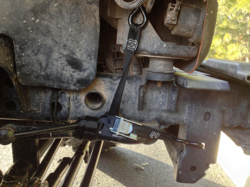

I want to see pix of how some of you guys are securing it when disconnected.. Please and thanks
this is also what I want to see. I've had this set-up for a couple months now and no idea how to secure while disconnected. everyone can "tell" me all day but I need visuals!!!
Old Jun 18, 2013 | 02:55 AM
  #98
kh202's Avatar
Posts: 3,142
From: Rockwood, TN
Only pic i've got. More convenient than zip ties in my opinion I actually attach both ends of the strap up top vertically, but either way will work. Works well for me. Hope this helps
