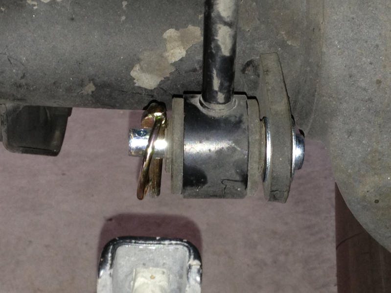

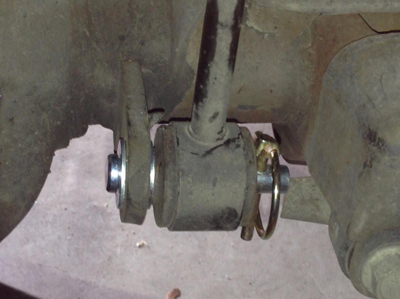

Did mine but had to go with 7/16 chevis pins on my 2010 Sahara. They fit snug and don't feel any difference. Great mod!
ID:	442886   Click image for larger version
Hey looks great! Let me know how it works on the trails. Don't forget to strap it up when u disconnect them.
