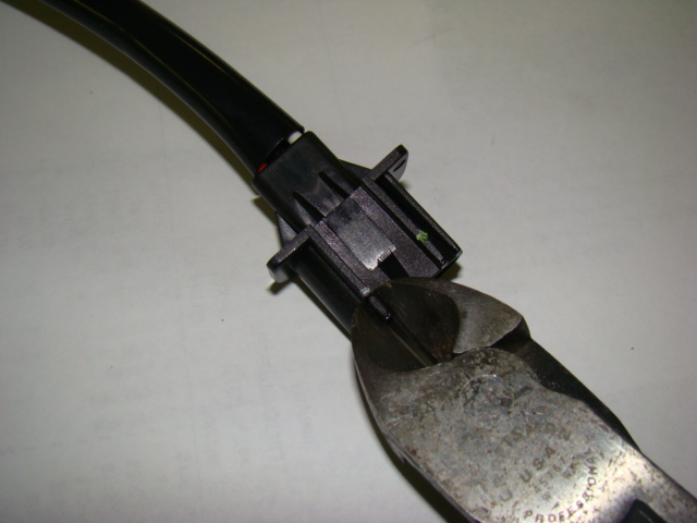

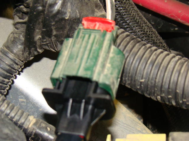

So on some of the jeep years you may have to "modify" the wiring loom on the IPF headlight kit to get them to fit properly. Until the harness is available. They are not perfect and I am very sorry about that and not to happy to be honest but after installing them and what it took to get them to fit it turned out to be a pretty easy fix
Here is some pictures to help you out I just installed a set in a 2007 and a 2008 and they both needed this fix.
Here is what the Plug looks like when plugged into the factory harness.
Notice the plug is approx 1/4" from bieng seated all the way.
Here is a picture of where you need to snip the plug
Cut vertical
Cut Horizontal
Insert plug all the way and if you use a small screwdriver you can push down on the tab inside the harness and it will "click" in . But just to be safe I added a few zip ties
That should do it and you will never have any issues but ARB is working on getting some new harness made and if you would like one give ARB tech a call and they will put on the list.
