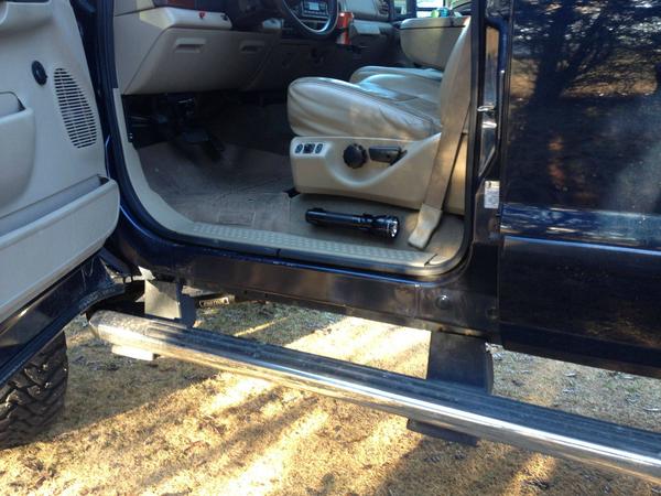

I liked this mod so much, I did it to my F250... I got the 2D LED and it's way brighter than my 4D.

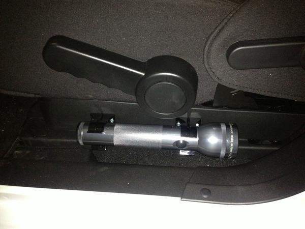

Default 2012 Seat Maglite Mount Installed
I installed the mount on my 2012 tumble front seat. I removed the panel which I mine had a hexagon mesh on the back as support for the panel. After drilling my mounting holes through the panel where I wanted them I dremeled out just a little of the hexagon support mesh on the back to put in some thick washers and nuts for all 4 holes. I was worried about the panel not supporting me pulling the light on and off without the mount being drilled right into the frame like you guys did for your 07-10 models. This little bit of extra work gave the support needed to mount it to the panel. I can remove and replace my 3d real easy without any stress on the panel. Thanks for the idea. I love having my mag so handy now! Here is a pic of it installed -

Its pretty easy. Just grab a socket and pull the panel off your seat so you can see what it looks like. I just added screws/washers/nuts, the largest that would fit through the predrilled holes on the maglite mounts. Then I measured and drilled the mounting holes into the panel. Then I test fitted the screws/washers/nuts, during the test fit you can see where the washers/nuts will be compressed against the hexagonal support on the back of the 2012 panel. I dremeled off a tiny amount for the large washers to compress down into the panel nice and tight. Its a strong hold and once bolted back up to the seat doesn't flex at all when I pull off or snap in my 3d mag. Hope this helps!
