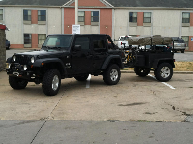

Here is my trailer build 48x54 box with a 48" tongue, 3.5k custom axle with 5-5 trailer hubs and spaced to fit jk wheels over dust caps. Used DIY fenders from sierra trailers and running 285r70r17 bfgs km2's. Trailer has a lift top and lockable tailgate. Made it mostly of 2x2 1/8th walled tube. Sided it with 22 gauge and Berliner...
