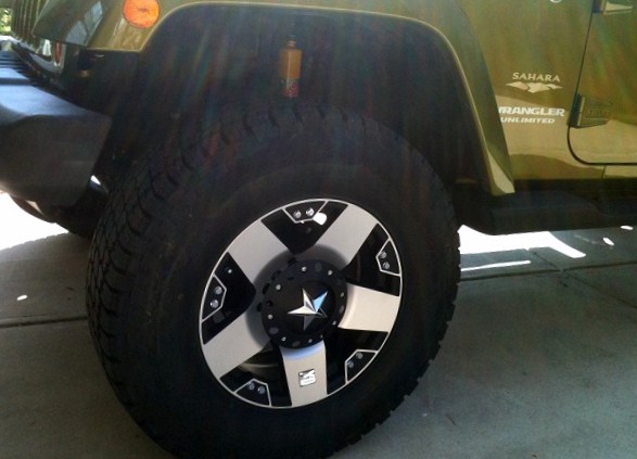

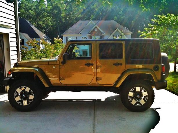

Default OME HD with 34" Terra Grapplers, Rockstar Machined Rims
I ordered my Old Man EMU from Northridge like almost two years ago. But then a whole bunch of stuff hit, but mostly a new baby and never had the time to either install or get new wheels. I wasn't about to install it with stock tires and rims. But for fathers day and the fact that the stock tires were getting worn anyway, I was able to go ahead and get it done. FINALLY!
Now when I ordered it, concensus was then that you didn't need new track bars or any of that jazz. Northridge didn't have a package available with it all. Also I was suggested to get the HD springs, even though I will rarely go off the beaten path with it. I was going to go ahead and follow the write up, but decided instead since I was able to get a deal with Rimz One for the tires, rims, and install all together (including alignment etc). Still, I printed out the instructions and I guess they used it for reference.
After the install, the alignment is as good as it can get, but it was done via computer and it's off by slight degrees. A rear track bar drop bracket should be all I need to fix it. I drove it a couple hundred miles this weekend after the install to SC all highway and no huge wobbles, but I could feel a slight pull when I started to make a lane shift. Nothing serious.
Maybe it's because I have the HD shocks, but while the ride is a little more smooth, it's still rough. Like you still get that jarring sensation going over railroad tracks. I don't know, the installer said the vehicle will both drop slightly (not much) and get softer as the springs compress, they are just too new.
Here's the pictures. It's way to hot and sunny for my to get a good shot right now...
