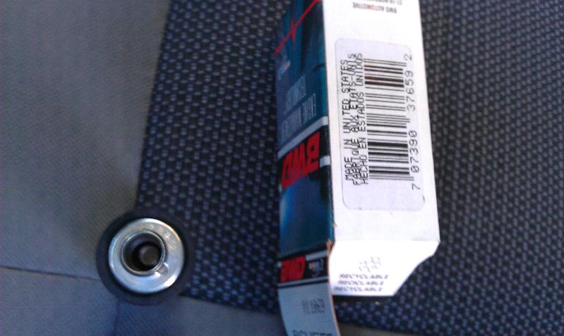

Just special ordered n picked up mine today. From oreillys auto parts. 9.99 or 10.99 dont remember. Part # on the pic will install next weekend let ya know how it goes. Hope it helps with the oil consumption

Sorry pic didnt attatch, this is the pic with the part#, also had 24 stamped on the inside. PCV 555. I beleive if u order the part monday- thursday they will have it the next day
