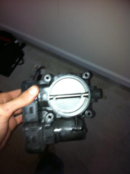

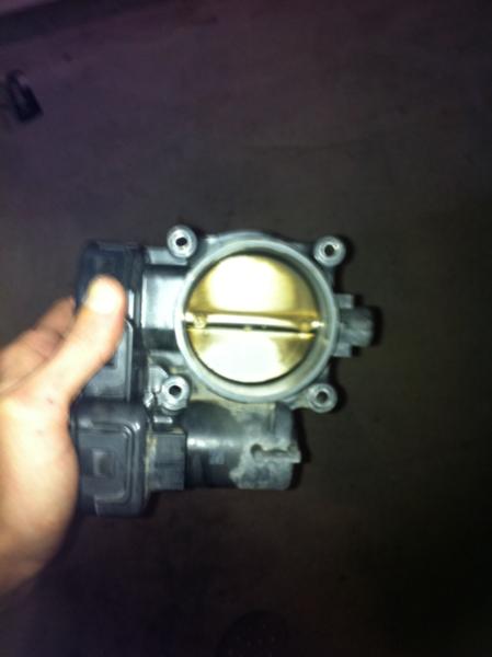

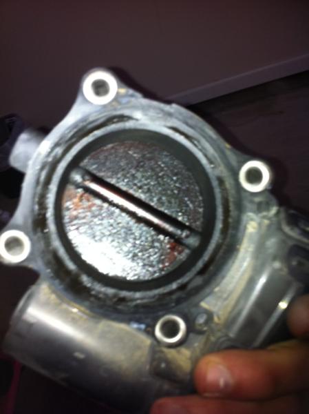

With the amount of KM's on my Jeep besides fluid changes what other sensors or valve systems should be looked at? And if they are within the normal DIY ability.
Old Nov 28, 2011 | 10:01 AM
  #55
GreenJK07's Avatar
Posts: 3,817
From: Covington, LA
Throttle body cleaning is a DIY and should also be checked along with MAS and PCV valve. Here's a pic of how dirty mine was from 50k.

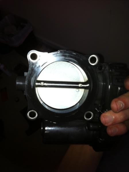

Old Nov 28, 2011 | 10:02 AM
  #56
GreenJK07's Avatar
Posts: 3,817
From: Covington, LA
All cleaned up:
