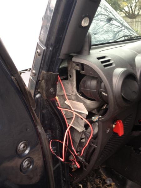

Got started, installed the switches while i was wiring up some led rock lights
