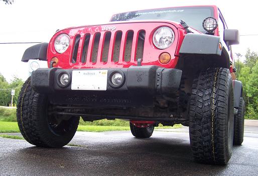

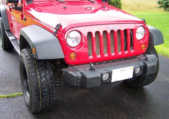

Finally, here are some pics of the final product. I tried the IMG tags route "motorvated" but unfortunately am computer illiterate sorry. I don't know how to make them click free yet!
