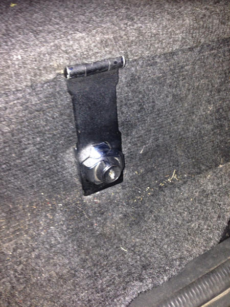

I secured mine by using two L shaped brackets screwed into the clips/tie down in the back and by using a piece of metal attached to the subwoofer mount. You could still probably break into it pretty easily but I just did it so shit don't start flying in the case of an accident.
I was curious if people were securing the entire box to the jeep floor or if the box was just set in place with a tight enough fit to restrict movement.

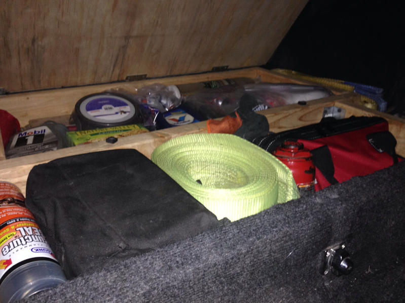

OK, here are the pictures. The first shows the storage location of the 2x3 spacer, the second is with the 1/3 seat section removed. You can see the 1/3 panel in its stored position behind the black toolbox. The 4 other panels fit under the rear seat.
Quite a bit of space under there for out of sight extra storage.

Just an update. This idea failed. The separate "boards" were always in the way. I went back to the hinged panels.
