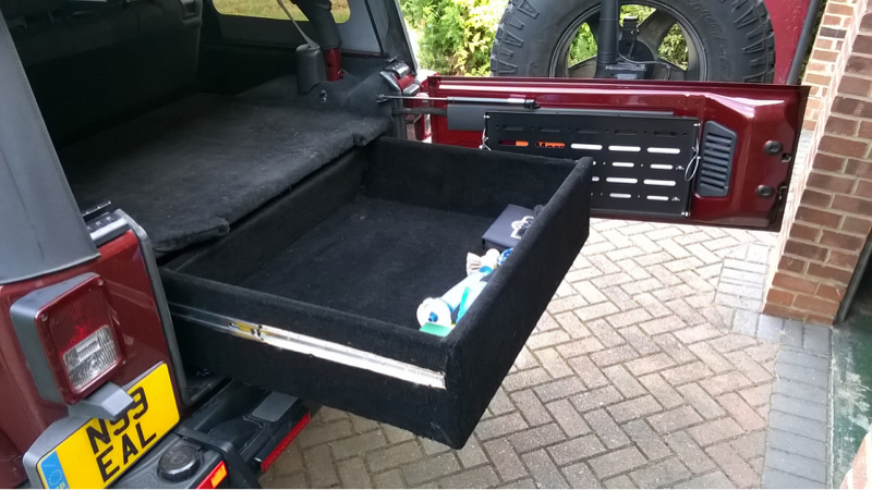

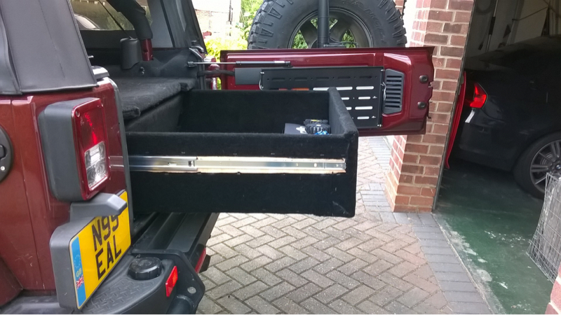

Not wanting to steal the thread, but here's mine.

You're not stealing the thread, this is what it's for. Great job, our builds are very similar. Looks like we both decided to stop just short of the door catch and contoured the box around the fold down table. Nicely done!
Thank,

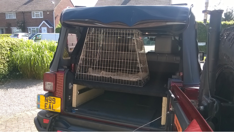

Looks like we both have 4 legged friends that needed to be factored into the build. I needed to get the dog create in for my 2 Beagles.
Nice! Our GSD Addie is known to have the world revolve around her, she is very well treated.
