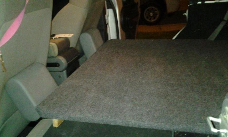

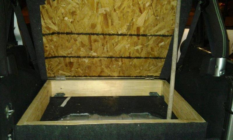

Ok finished up most of it tonight. Have one more mod I'm going to do before calling it complete. Easiest part is framing up the bottom. I actually used brackets to be sure it stay's square. They were like $1.50 each. Next came the top panels. Cut first lid to match curve of door.
Next cut the folding panel. I didn't seporate the sides because I'm never going to put just one side down. When cutting this part out I had to go to 29" because otherwise it would hit the rollbar when trying to fold open. Even at 29" I had to radius the edges of the panel to get them to fit. They are still snug.

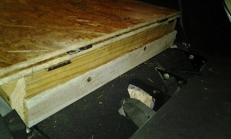

Mount hinges. I used door hinges. On the 5/8 OSB even my 240lbs couldn't budge the wood . You also get a look at the support board tucked away.
It sits level on a 1x4
Just before carpet. They arm rest upgrade makes a GREAT pillow actually.

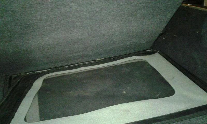

ok here are a few more photos.
Storage area easily fit shopping bags back there when out with the wife. Now I don't have to haul all my bags inside to go xmas shopping.
