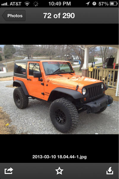

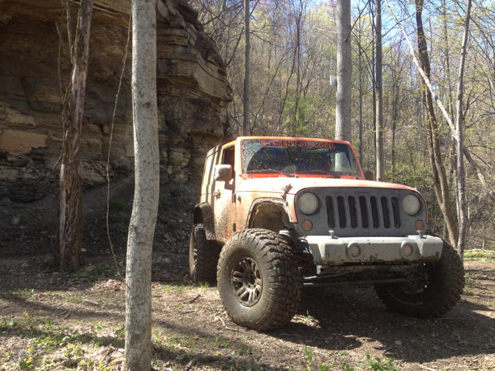

Old Apr 21, 2013 | 07:48 AM
kh202's Avatar
Posts: 3,142
From: Rockwood, TN
Love my 15's. make the tires look beefier. Contact discount tire direct. They have a list of 15's that fit on jk.
